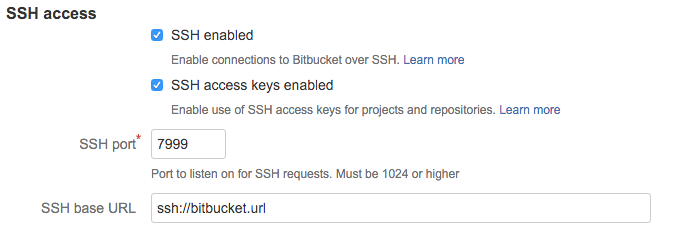

    1. Check the Bitbucket Server SSH access settings at Administration > Settings > Server settings. The SSH port value must be appended to the SSH base URL otherwise, the default value, 22, will be used which requires an additional port forwarding configuration to be setup via a (reverse) proxy. For example, the following setup shows that the port is set to 7999 but since the SSH base URL is ssh://bitbucket.url, this means that using SSH, the repositories can only be reached on port 22 and implies that you've also set up a proxy.
      Example: Bitbucket Server SSH settings
