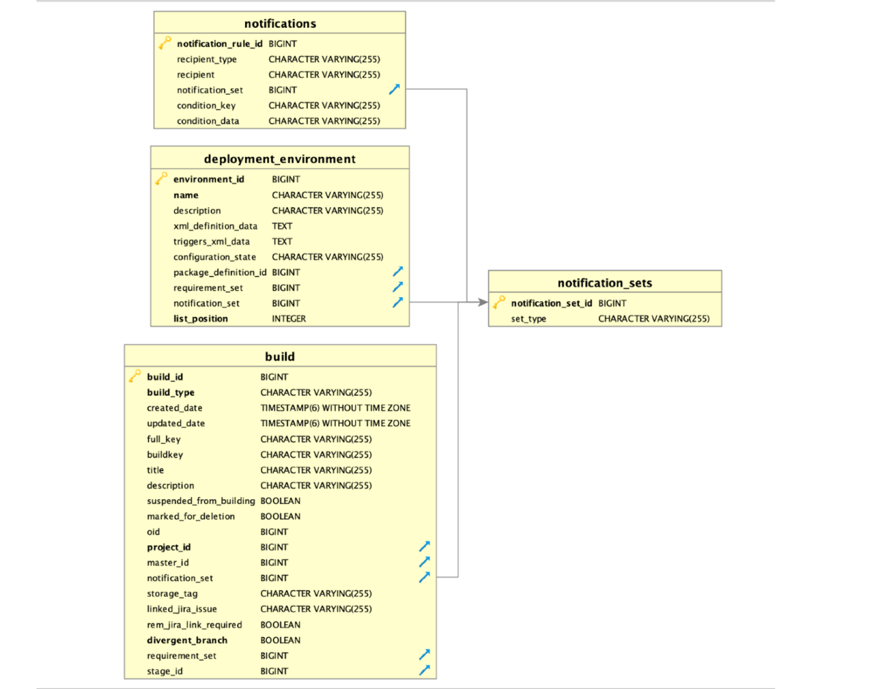

The details related to email recipients is store in a table called notifications under column recipient.
This table is internally linked to another table called notification_sets which in turn is linked to build and deployment_environment tables to link this notification to builds or deployments.
