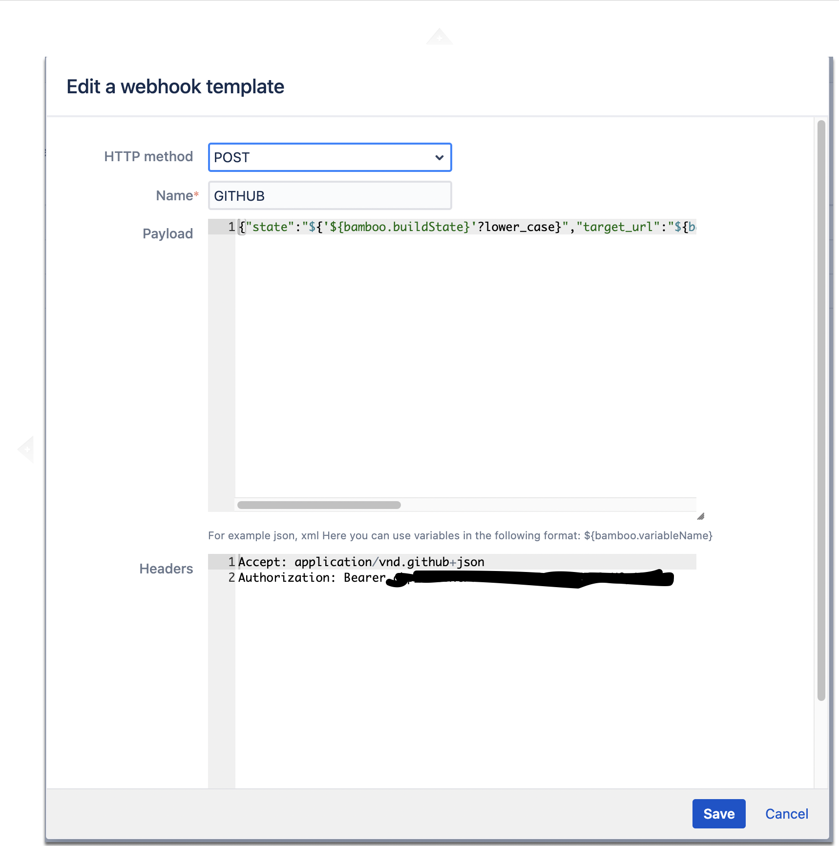

2. Next step is to set up Webhook at Bamboo side with the below Payload and Header. (Overview→ Communication→Webhook Templates→Add Template)
Webhook Set up in Bamboo
Set up the Webhook as below
Payload
1 {"state":"${'${bamboo.buildState}'?lower_case}","target_url":"${bamboo.buildResultsUrl}","description":"${bamboo.buildState}","context":"continuous-integration/bamboo"}
Header
1 2 Accept: application/vnd.github+json Authorization: Bearer <use your github token>

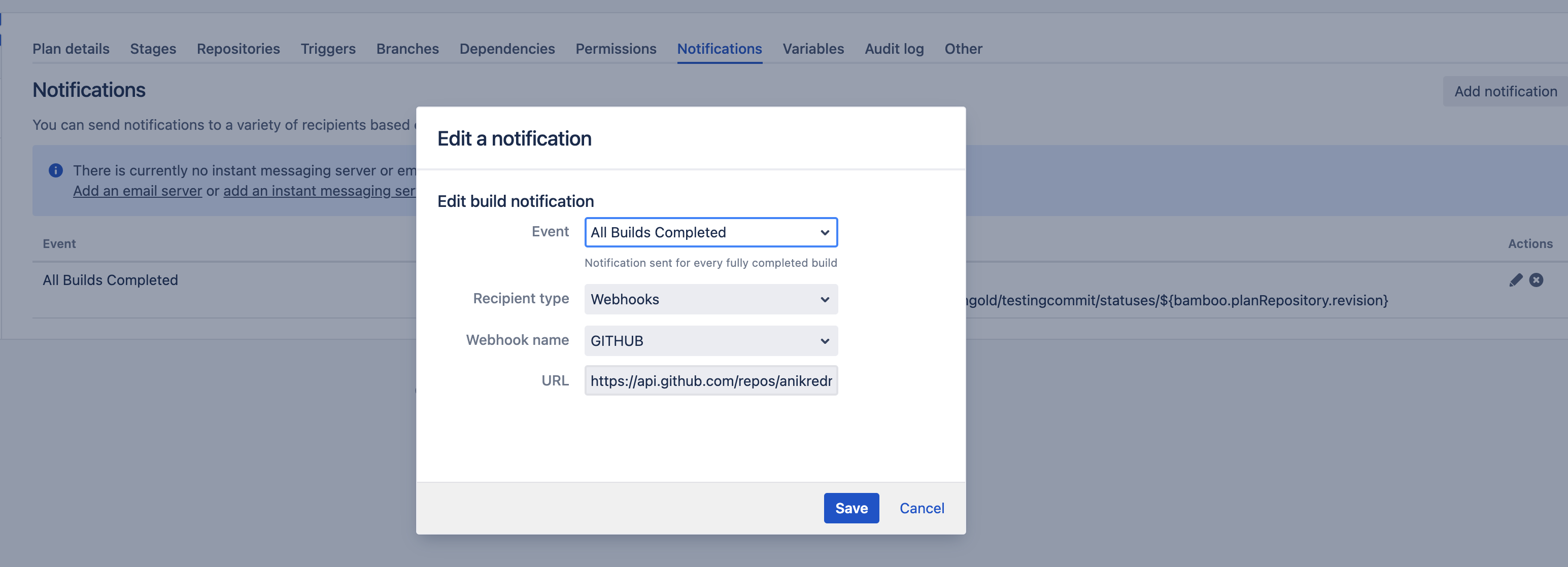

3. Next step is to send Bamboo build status for a commit done in GITHUB, we can make use of Notifications i.e send Webhook as notifications for this purpose. To set up notifications go to (Plan->Actions→Configure Plan->Notifications→Add Notifications→Notification Type as "Webhook" →Select the template used above and the URL )
Webhook notification example.
The URL as per REST API endpoints for commit statuses should be as below :
1 https://api.github.com/repos/ <GitHub username>/<repo name>/statuses/${bamboo.planRepository.revision}
