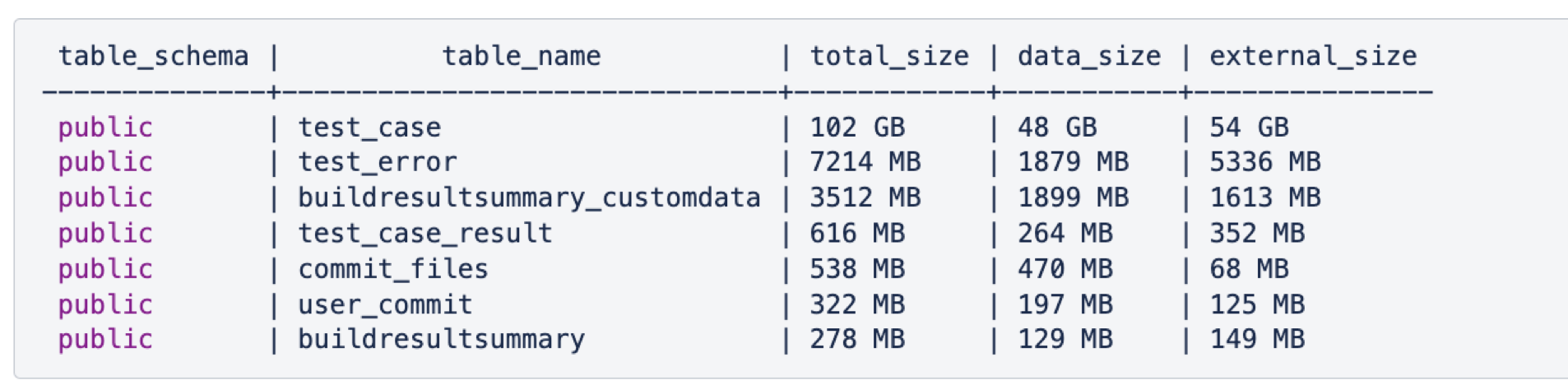

The first step is to identify the large tables which are occupying the space in DB file system by running the below query
SELECT SCHEMANAME AS table_schema, RELNAME AS table_name, PG_SIZE_PRETTY(PG_TOTAL_RELATION_SIZE(RELID)) AS total_size, PG_SIZE_PRETTY(PG_RELATION_SIZE(RELID)) AS data_size, PG_SIZE_PRETTY(PG_TOTAL_RELATION_SIZE(RELID) - PG_RELATION_SIZE(RELID)) AS external_size FROM PG_CATALOG.PG_STATIO_USER_TABLES ORDER BY PG_TOTAL_RELATION_SIZE(RELID) DESC, PG_RELATION_SIZE(RELID) DESC LIMIT 20;
The result would look something like below, here we can see tables like test_case, test_error, test_case_result occupying good amount of space on the DB.

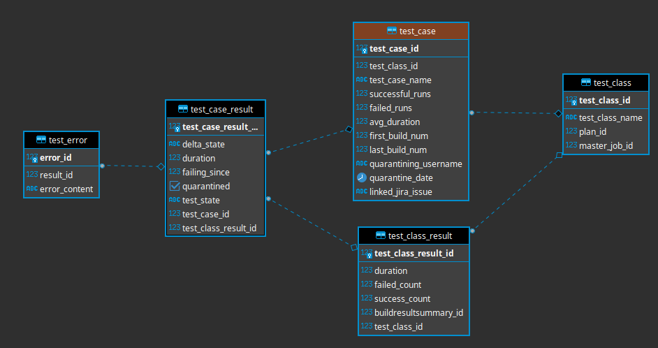

The below diagram explains about the relationship between these tables

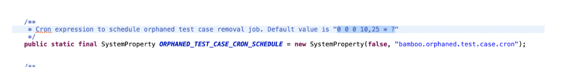

The data is populated in these tables when a build is run which contains test_cases to be executed. One of the probable reason why these table will grow is size is because of large number of test cases produced as part of builds results of a plan. As part of Bamboo Global expiry build results are deleted, but the test cases of these build results are not immediately deleted.
These test cases become orphaned and later these are removed as part of test cases scheduled cleanup jobs which runs on 10th and 25th of every month in it's scheduled setting, refer below
From Bamboo 9.6 the above schedule has been changed to run every Sunday instead of 10th and 25th of every month.
