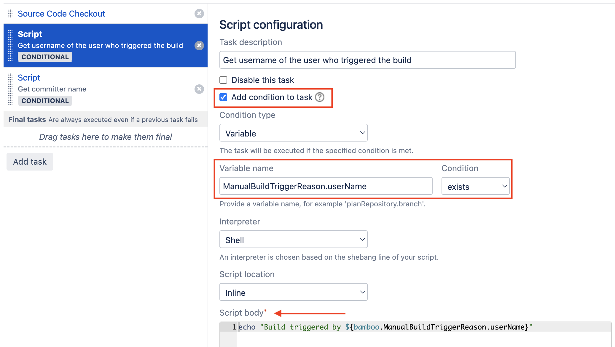

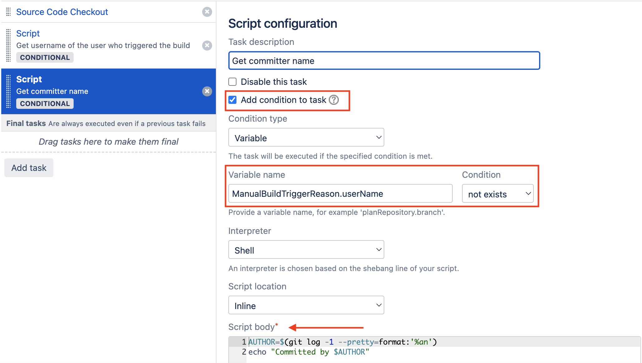

Solution for both automatically and manually triggered builds
In order to implement a way that works for both manual and automatically triggered builds in the same workflow, you can add both Script tasks mentioned above, but with conditions for their execution: if the variable ManualBuildTriggerReason.userName
exists, the script for Manually triggered builds should be executed. If it doesn't exist, the script for Automatically triggered builds should be executed. E.g.,
