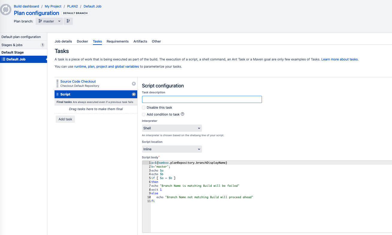

In this article we'll go through steps to achieve this behaviour by using a script task in Bamboo. It's not possible to control the trigger, but we can have a Script Task as the first task of the Job and write a logic based on the plan branch name variable which will decide if the build proceeds ahead or fails.
Environment
All supported versions of Bamboo.
Solution
The workaround is to have a Script Task as the first task of the plan and use the Bamboo variablebamboo.planRepository.branchDisplayName to compare this value to a pattern and pass or fail the build. Please see the below examples for Linux and Windows interpreters.
In the scripts below, we use two variables. One of the variables contains the branch name; the other contains the pattern we want to match. If the pattern matches, exit 1 is called, and the Script task fails, causing the Job not to proceed ahead.
Linux
Linux Example
1 2 3 4 5 6 7 8 9 10 11 a=${bamboo.planRepository.branchDisplayName} b='master'; echo $a echo $b if [ $a = $b ] then echo "Branch Name is matching Build will be failed" exit 1 else echo "Branch Name not matching Build will proceed ahead" fi
Script task configured in Bamboo:
