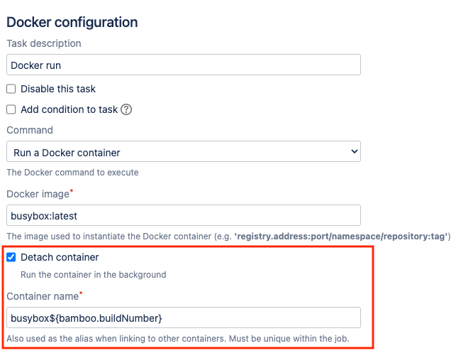

You can use the Detach container checkbox to start a container in a task in detached mode, and then use that same container in subsequent tasks (e.g., to run tests). However, the container will still be removed once the build job has finished.
Detached container checkbox
The Container name must be unique. Please note that the job will fail if there's a container already running with the same name. You can use a variable, like ${bamboo.buildNumber} to work around that.

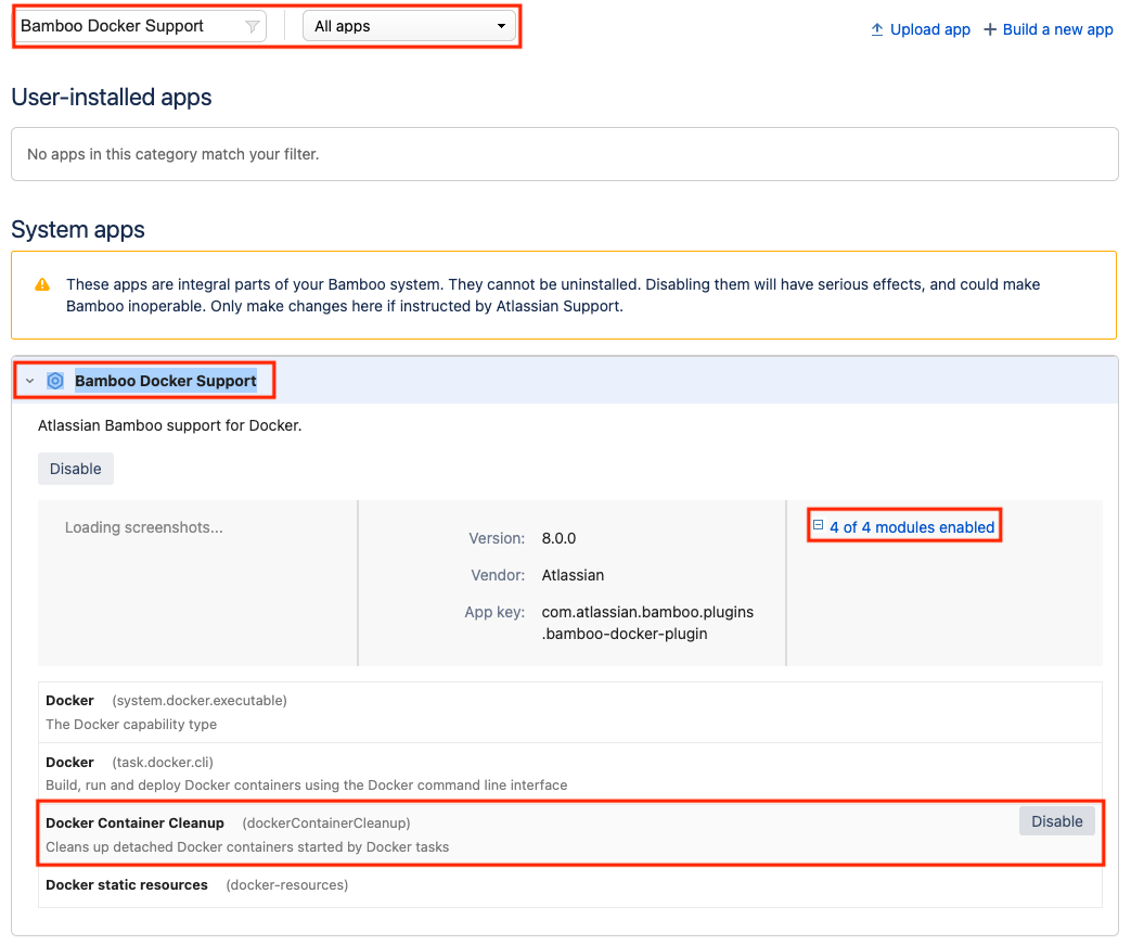

Option 2: Modify the default behavior of the Docker Plugin bundled with Bamboo
There is a way to disable the "Docker Container Cleanup", which is the post-build plugin that removes the containers. It's a module of the bundled Bamboo Docker Support Plugin that can be disabled through the following steps:
  1. Log in as a Bamboo administrator
  2. Click the "Cog" icon >> "Overview"
  3. Open "Manage Apps"
  4. In the drop-down menu, select "All apps"
  5. Search for "Bamboo Docker Support"
  6. Click "4 of 4 modules enabled"
  7. Scroll a little further down to "Docker Container Cleanup"
  8. Click "Disable"
By doing that, the post-build plugin won't be executed anymore, therefore, the containers will not be deleted once the build finishes.
Please note that the container name must be unique. The job will fail if there's a container already running with the same name (e.g., from a previous build run). You can use a variable, like ${bamboo.buildNumber}  to work around that.
