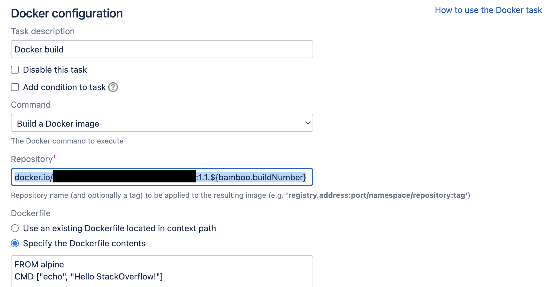

You can use Bamboo's build number variable (or any other suitable Bamboo variables) in the Repository field as the image's tag. For example, the following configuration can be implemented:
  1. Build a Docker image task configuration
    registry.address:port/namespace/repository:tag.${bamboo.buildNumber}

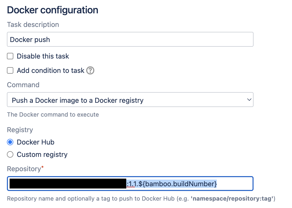

  2. Additionally, if you also use a Dockerpush task, it also accepts variables in the Repository field:

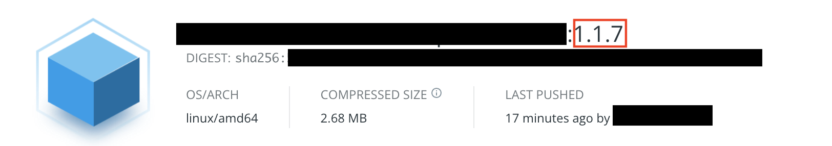

And the Image gets pushed successfully to the registry:
