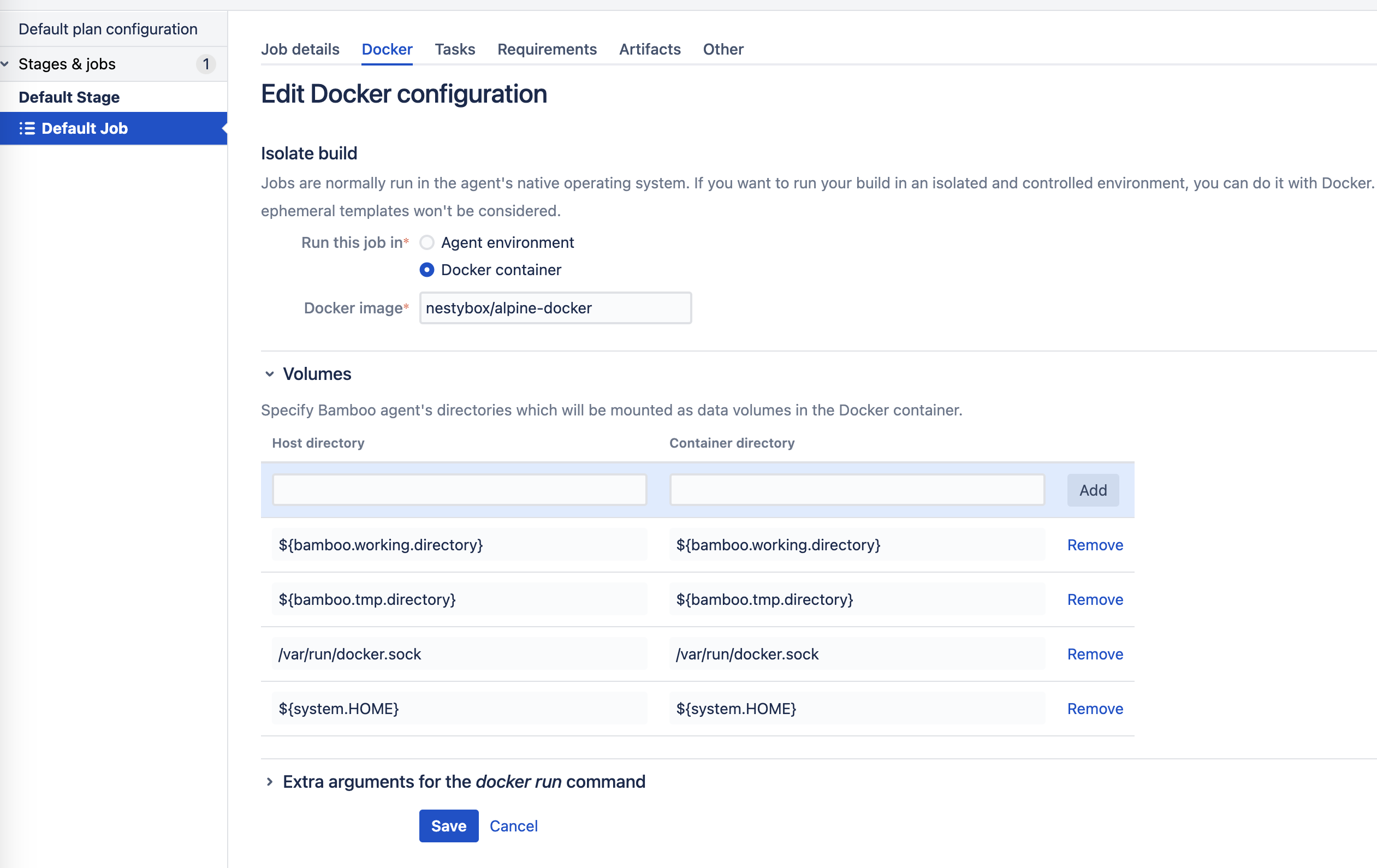

  1. When configuring the Docker Runner, an additional volume needs to be added along with the default volumes ${bamboo.working.directory} and ${bamboo.tmp.directory}. So that the Docker Runner container can get access to the config.json file available in the Bamboo Remote Agent's user home directory.
  2. During Docker Runner configuration, add an additional mount volume ${system.HOME}. This way, Docker Runner can access the home directory of the Bamboo Remote Agent host machine.
  3. For running the docker (Docker Task) inside the docker (Docker Runner), the Docker daemon /var/run/docker.sock also needs to be mounted.

  3. Configure the Docker Runner agent same as mentioned in Scenario 1.
If the agent is configured to run as a service, then ${system.HOME} may not work. In that case, Add additional volume as below:
    1. Host directory: Home directory of the user running the Bamboo remote agent (eg. /home/bamboouser)
    2. Container directory: Home directory of the user running the Docker Runner container (eg. /root)
