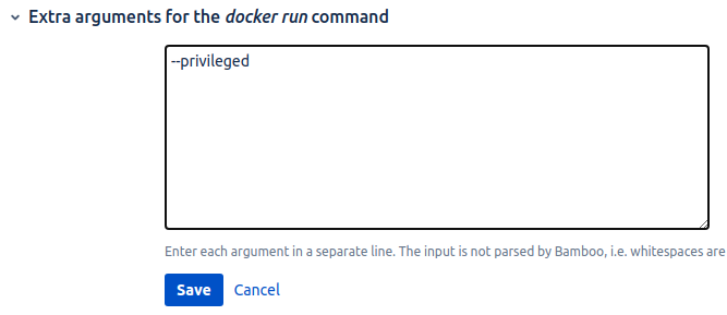

Run container in a privileged mode
This is possible only in 7.1+ versions with the introduction of extra Docker run arguments. Running containers in a privileged mode can also open security risks, so, do it with caution:

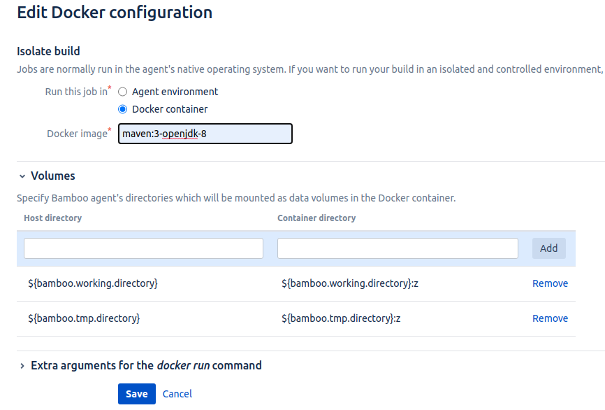

Add :z suffix to volume mount binding
You can also let Docker do the labeling for you by appending :z suffix to a volume mount binding (container directory) in Bamboo UI (Docker configuration for a job).
