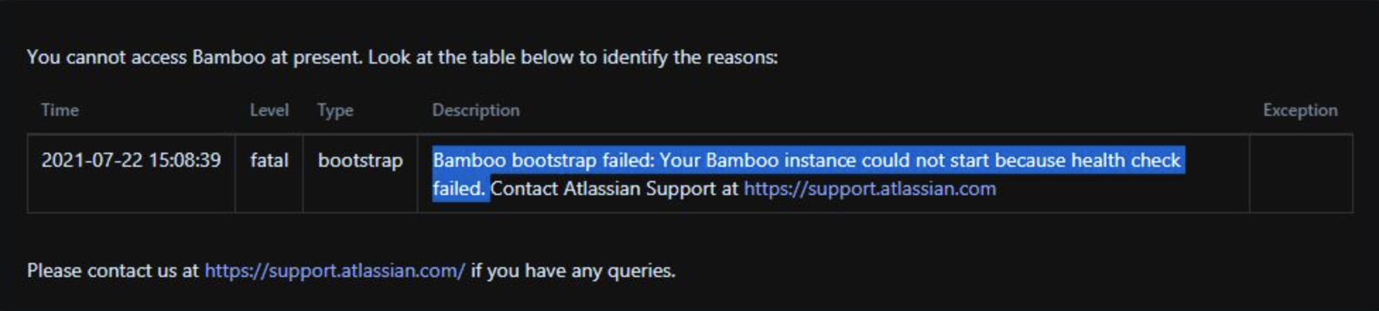

During the Bamboo upgrade, when using a non-supported Database, the following error may occur:
Error at the UI should look like this:
Bamboo bootstrap failed: Your Bamboo instance could not start because the health check failed. Contact Atlassian Support at https://support.atlassian.com
