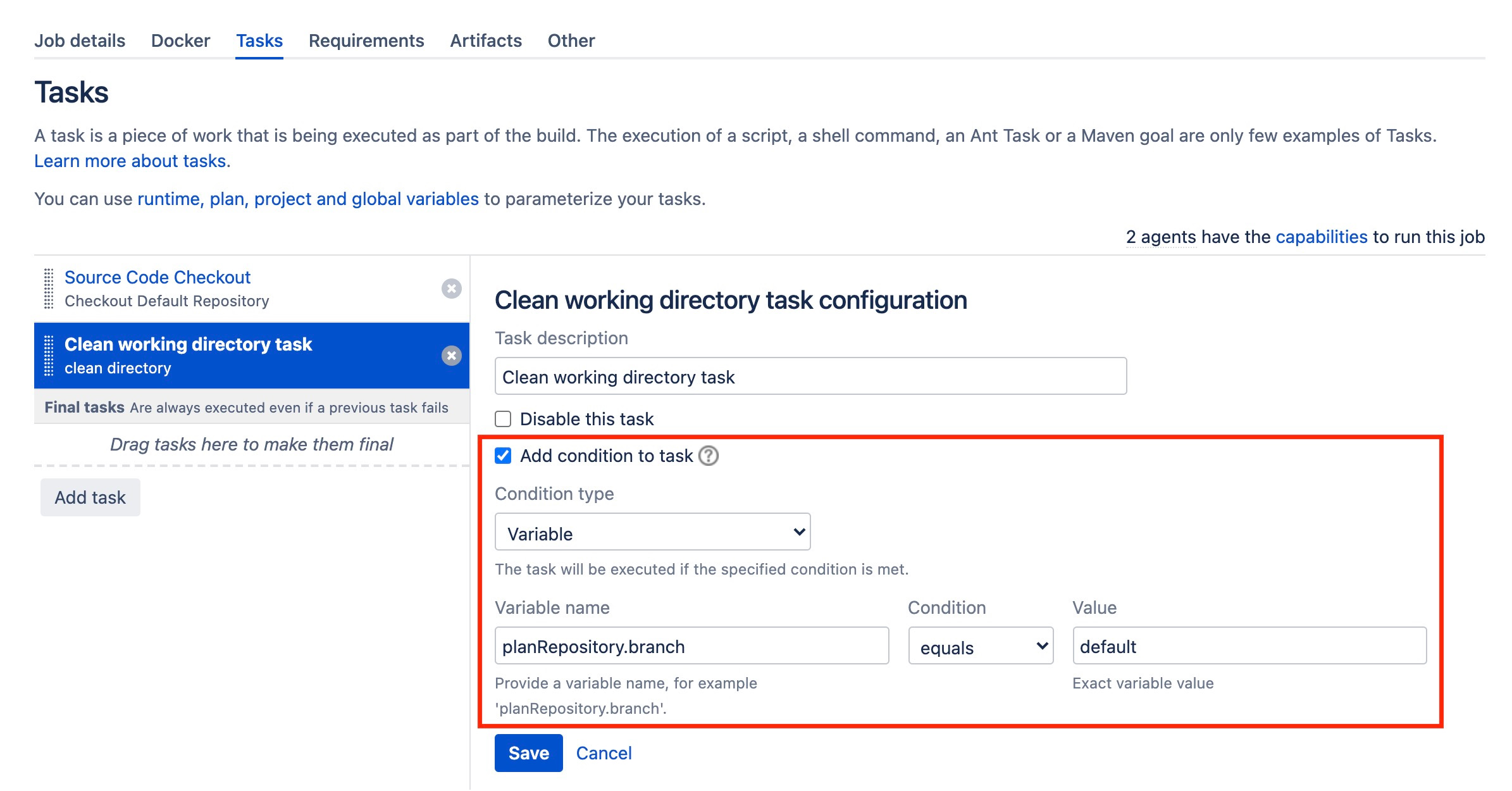

You can use variables and regular expressions to create conditions that have to be met to run a task. This way you can skip build steps in plan branches, decide what tasks are mandatory and what could be skipped, etc. You can set conditions for tasks through Bamboo UI or by using Bamboo Specs. For more information, see Configuring Tasks.
The variable name shouldn't begin with bamboo. E.g., the variable bamboo.planRepository.branchName should be added as planRepository.branchName.

The "Add condition to task" box is not visible
Bamboo 7.1 or newer:
A common cause for the box not being visible is that the bundledplugin is installed, but not enabled. In order to fix that:
  1. Click the
    icon > Overview > Manage apps under the Manage apps section
  2. Switch the filter to "System"
  3. Search for the "Conditional Tasks" plugin
  4. Click on Enable

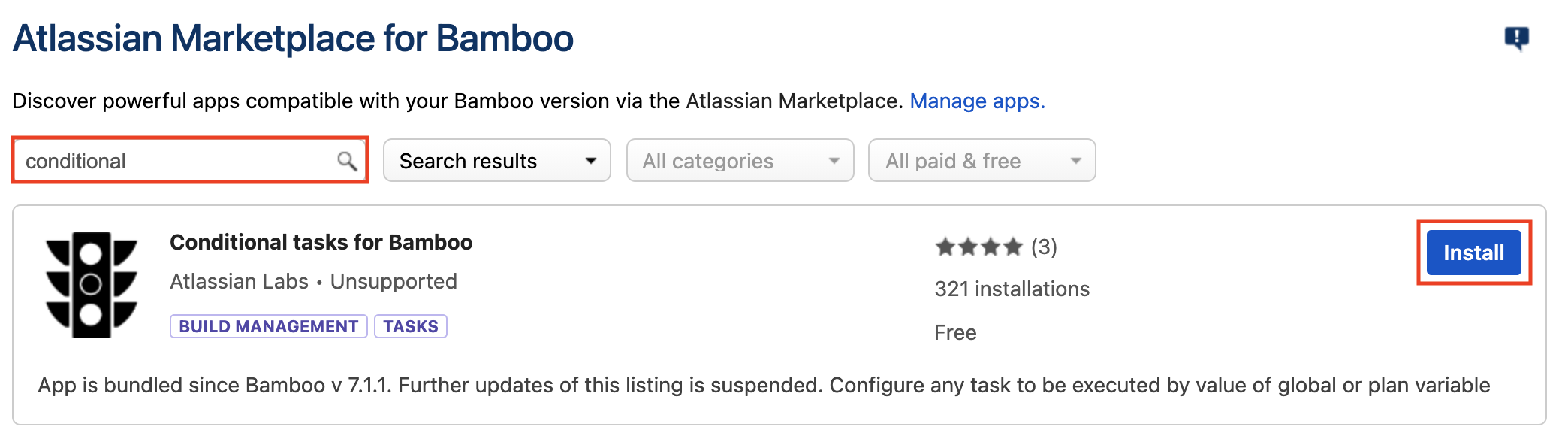

Bamboo 7.0 or older:
You'll need to install the plugin
  1. Click the
    icon > Overview > Find new apps under the Manage apps section
  2. Search for "Conditional Tasks"
  3. Click on Install
