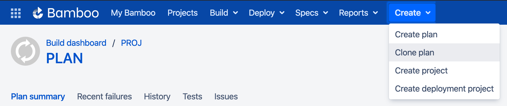

Bamboo 5.10 to 9.6
Workaround: Reset the build number
If you need to "reset" the build number to 1, you can do this by cloning the build plan via the Create menu, Clone plan.
After cloning and verifying all is configured correctly delete the old build plan and revise all external links to point to the new one.
Cloning a plan will not clone build result history or plan branches.

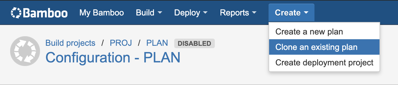

Bamboo 5.9 and earlier
If you need to "reset" the build number to 1 this can only be achieved by cloning the build plan via the Create menu, Clone an existing plan.
