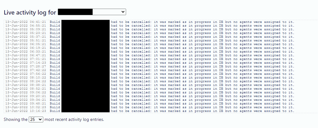

Builds get stuck in the "Build is currently being stopped" while the build status shows "Building".
The agent that was processing the build has already moved on to other builds.
The build logs show the following messages:
1 13-Jun-2022 05:23:21 Build PROJ-PLAN-JOB-# had to be cancelled: it was marked as in progress in DB but no agents were assigned to it.

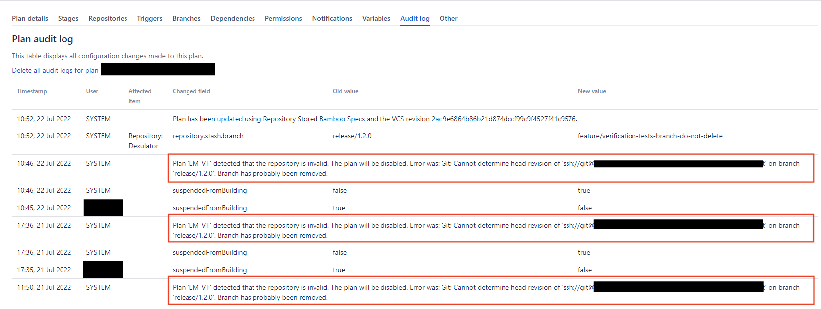

By checking the plan's audit logs (Plan > Actions > Configure Plan >Audit log), the following messages regarding invalid repository configuration can be seen:
1 Plan 'PROJ-PLAN'detected that the repository is invalid. The Plan will be disabled.
