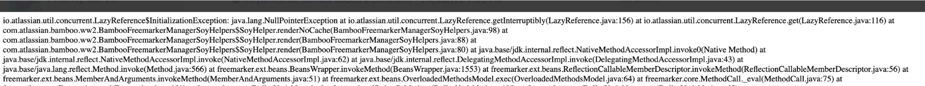

Bamboo Upgrade is failing post DB initialization stage with the below error.
ERROR [https-jsse-nio-8443-exec-4] [runtime] Error executing FreeMarker template FreeMarker template error
io.atlassian.util.concurrent.LazyReference$InitializationException: java.lang.NullPointerException at io.atlassian.util.concurrent.LazyReference.getInterruptibly(LazyReference.java:156)

  • During the Bamboo upgrade process post DB Initialization stage, Bamboo GUI fails to come up and below error message in seen on the screen.
  • Bamboo Logs also confirm that the DB initialization was successful. Below log messages would be displayed.
INFO [performSetupDatabaseConnectionBackgroundThread] [SetupDatabaseConnectionAction] Validating connection to url: INFO [performSetupDatabaseConnectionBackgroundThread] [SetupDatabaseConnectionAction] Database configuration is valid.
  • Immediately post the above log messages 500 Exception related error would be present in the logs.
ERROR [FiveOhOh] 500 Exception was thrown. ERROR [runtime] Error executing FreeMarker template
