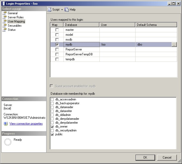

You need to check the Bamboo DB user which is used to connect to DB is having all the correct privileges, you can refer the below 2 parameters in <bamboo-home>bamboo.cfg.xml to get the DB details.
<property name="hibernate.connection.url"></property> <property name="hibernate.connection.username"></property>
Assign the 'db-owner' role on the database for the user that will access the Bamboo database — the 'db_owner' fixed database role allows the user to perform all configuration and maintenance activities on the database. You need to add this role to the Bamboo user used to access your database by updating the login properties for your database user in SQL Server. Read more about login properties for SQL Server.
Screenshot: Adding the 'db_owner' database role to a database user in SQL Server
You can read more about it Connect Bamboo to a Microsoft SQL Server database
