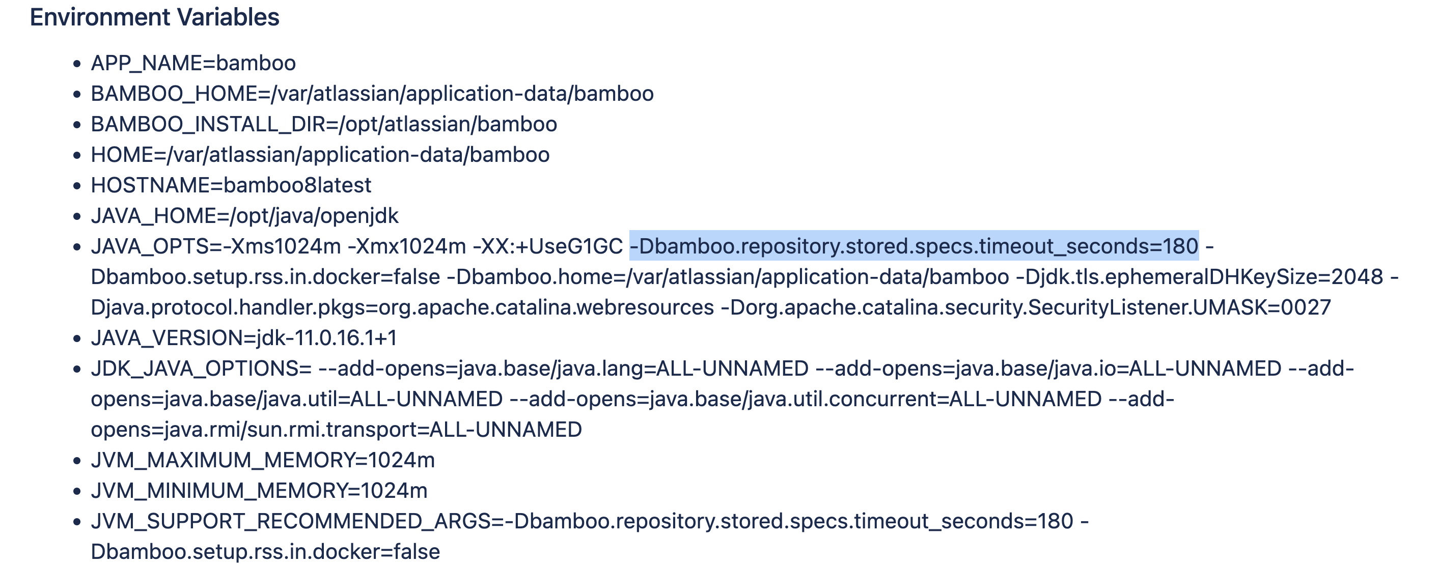

  5. You can double-check if the property has been picked up by Bamboo by going to Bamboo Administration > Overview > System information and looking for it in the Environment variables section:
  6. Run your Specs again, and it should now succeed (as long as the Bamboo is able to process the specs within the new value timeout set).
