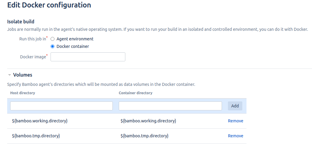

When using default volume mount bindings in job docker configuration, the environment variables will be resolved to /opt/atlassian-bamboo/agent-home/temp and/opt/atlassian-bamboo/agent-home/xml-data/build-dir/PROJECT-PLAN-JOB

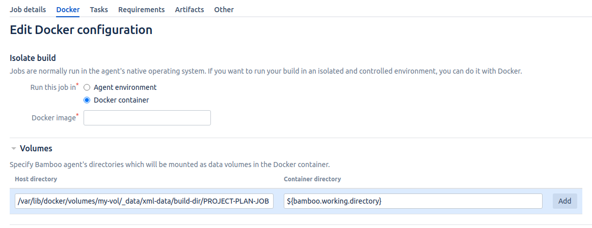

If a named volume was used, there's no universal solution that automatically works for all jobs. Since named volumes are stored in /var/lib/docker (or whatever Docker root is configured), an absolute path to the volume should be provided in volume mounts when a job is configured, for example:
Click to see a larger image
This approach has 2 downsides:
  • an absolute path to job's working directory needs to be provided, which you may not know upfront but can predict by using project, plan and job keys
  • a custom volume mount binding has to be provisioned for every new job that's run in Docker
