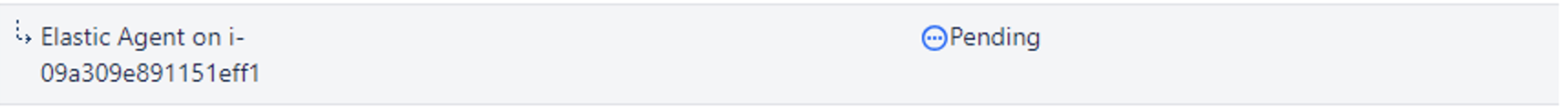

Bamboo elastic agents get stuck in a pending state for a long time. View the instance using ,select
cogwheel icon
> Elastic Bamboo > Instances. This shows the below as the state of the instance:
