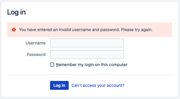

This article covers a scenario where login to a UAT/Dev instance of Bamboo was not working post refreshing it's Database from Production. Following error was seen : You have entered an invalid username and password. Please try again

  1. While trying to login to Bamboo using the users imported from Crowd, below error was seen on the Bamboo GUI
