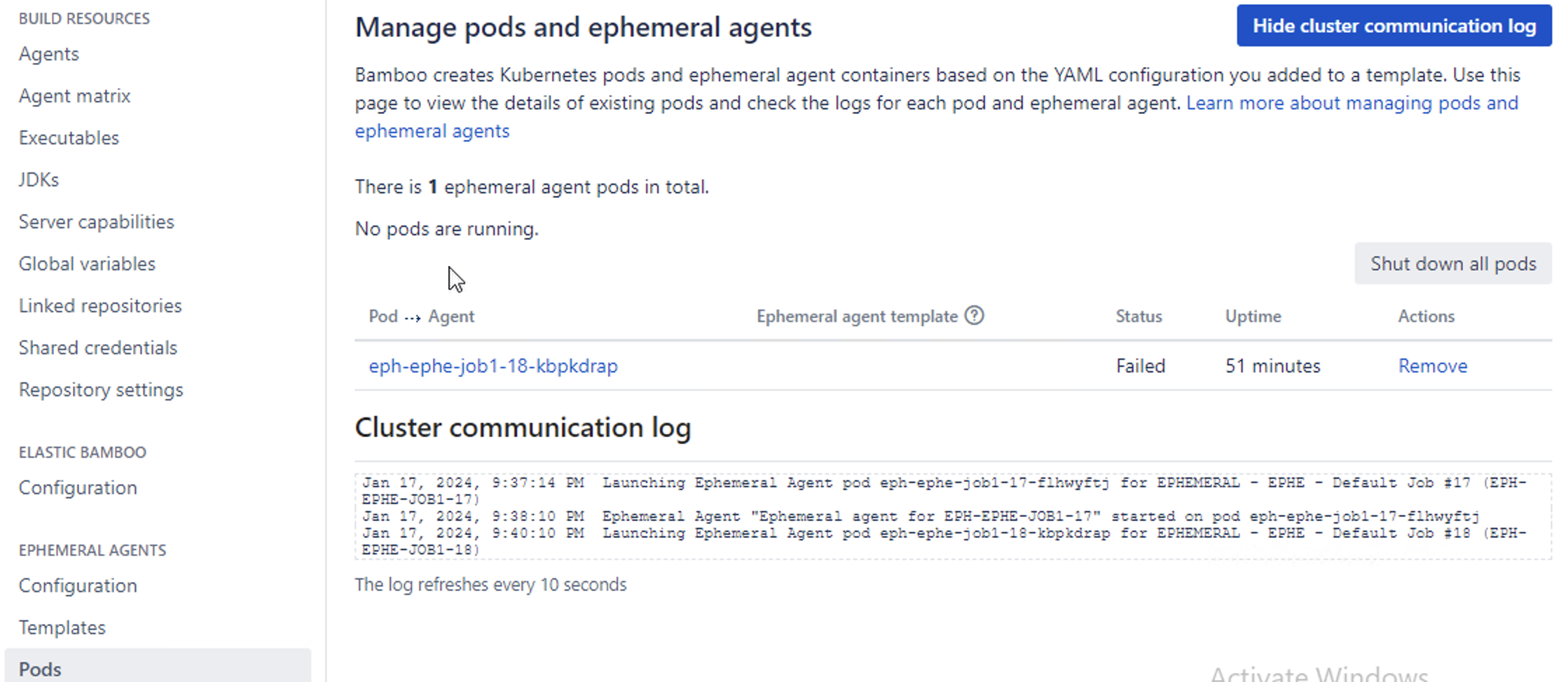

Below message is seen on the Pods section on the Ephemeral Agents configuration on Bamboo GUI.
An investigation in the Kubernetes cluster shows the pod in an error state
