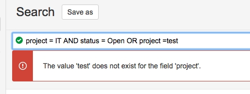

While trying to run an advanced JQL query such as:
Code
1 project = IT AND status = Open OR project =test
it will result in the below error:
Even though the first two statement are true and the third statement is in "OR" clause.

  • Run a JQL with a value that does not exist for a field. For example, in the below JQL:
  • project = IT AND status = Open OR project =test
    the value "test" does not exist for the Field "project".
  • It does not matter if it is with the OR section.
Cause
The main cause is that JIRA can not search for a value that does not exist and it is equivalent to looking for NULL. It may seem that it is using an "OR" operand but the value needs to be present in order for the JQL to process.
Solution
Resolution
Please make sure that the value exist for the filed that you are trying to search.
