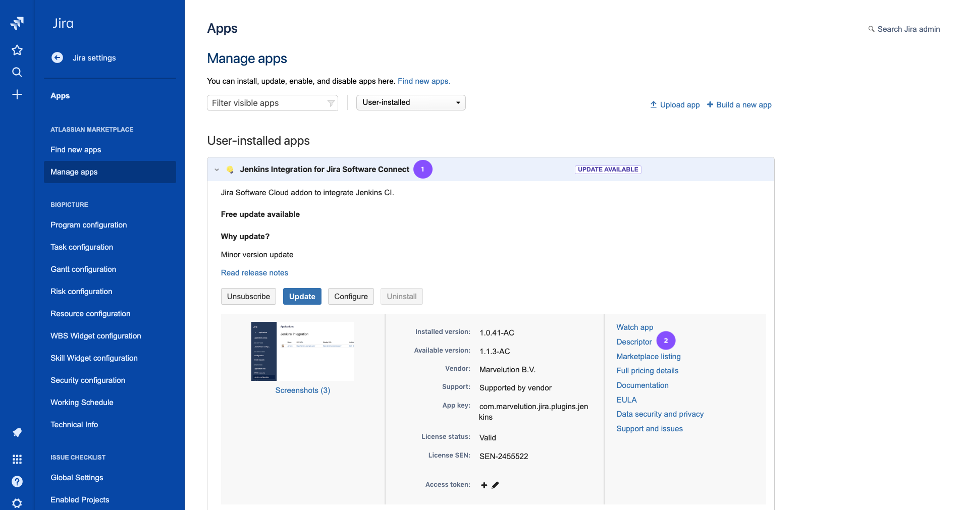

  1. Confirm the issue is caused by an app

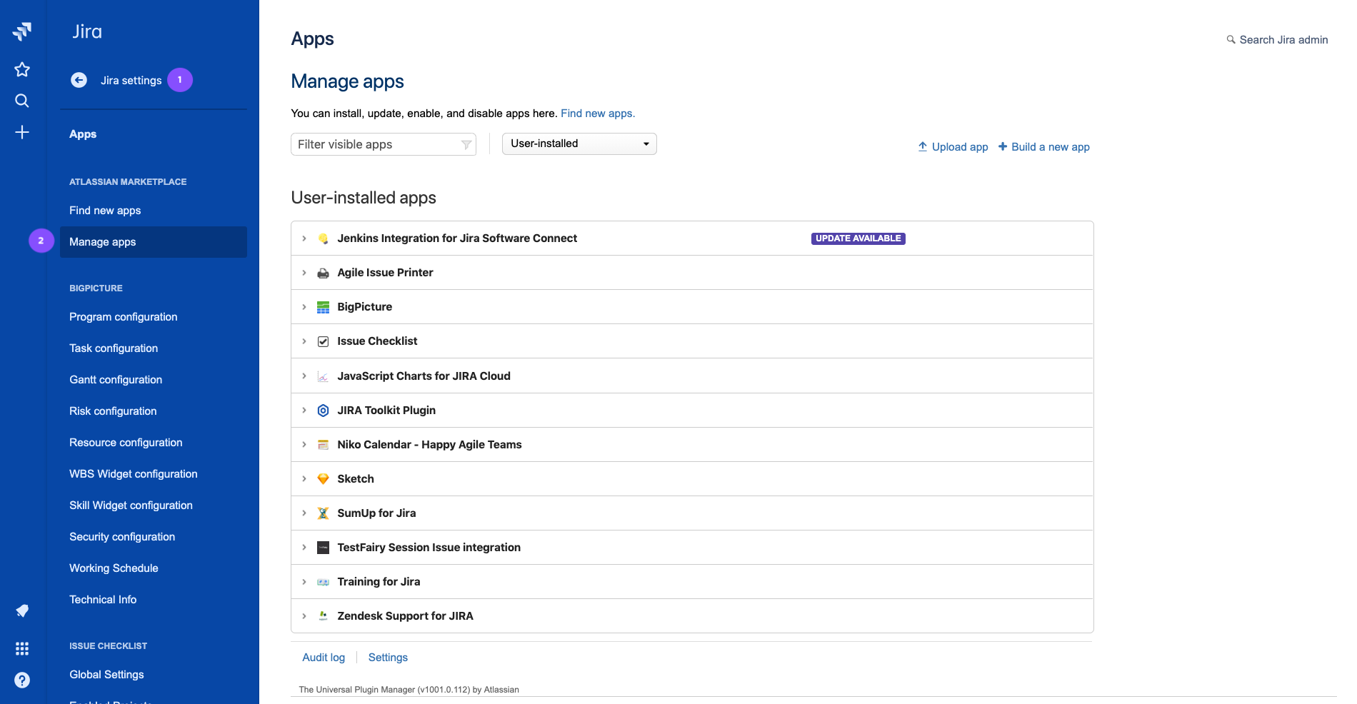

    1. Check the Manage apps page in your JIRA or Confluence cloud instance to find the list of apps that have been installed in your cloud instance. (Jira settings > Apps > Manage Apps) or (Confluence settings > Manage Apps (navigation requires a scroll down)

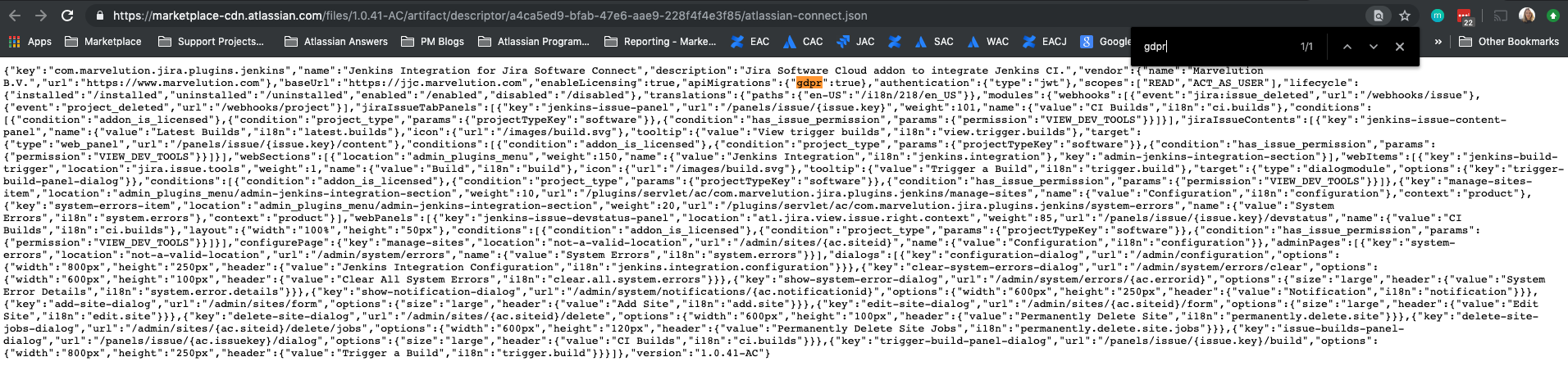

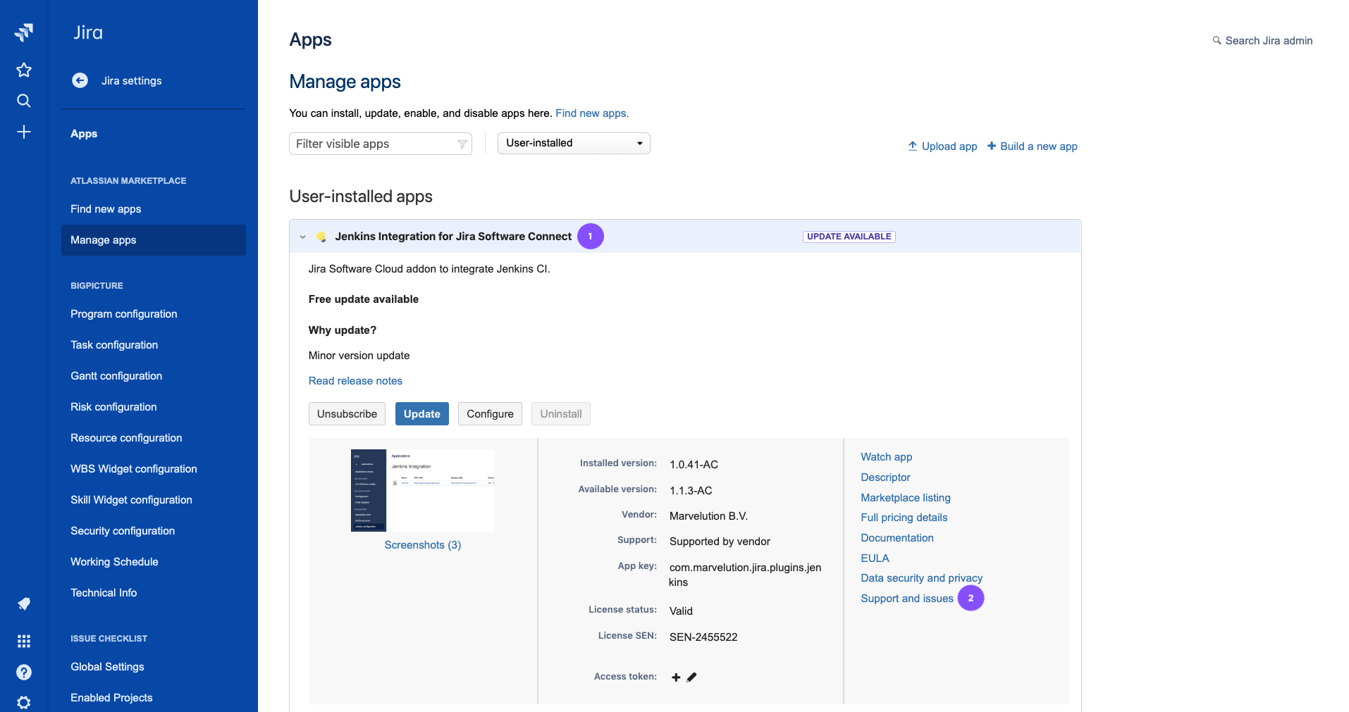

    2. Expand the app details to find the the descriptor link. (Click on the app name)
    3. In the descriptor, search for "gdpr".
    4. If not found or found `gdpr:false` then proceed to step 2.
    5. If found `gdpr:true` then try disabling the app to determine if the issue stops. If the issue stops after disabling then the app is likely not the cause. Otherwise, proceed to step 2.

    1. On the Manage apps page in your JIRA or Confluence cloud instance, look for the Support and issues link.
    2. Find the "Vendor support resources" and check the documentation first.
      Check the Atlassian Marketplace Vendor documentation first. They may have similar knowledge base articles to help you self resolve some of these issues.
  3. If the documentation does not help, contact the app vendor (see contact details)

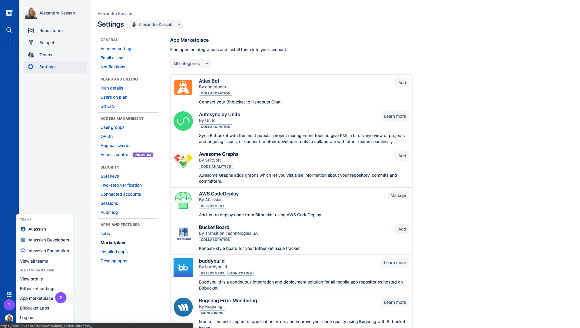

  1. Check the App Marketplace in Bitbucket (Click your profile picture in the nav bar > App marketplace)

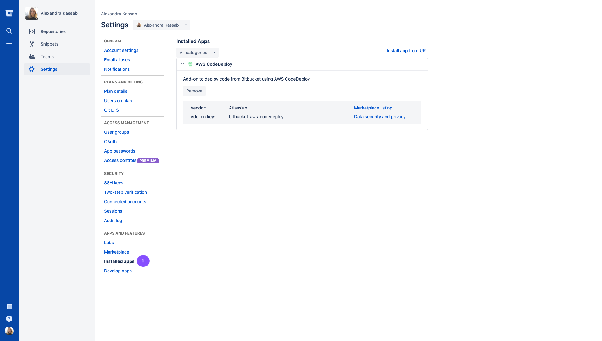

  2. Click Installed apps

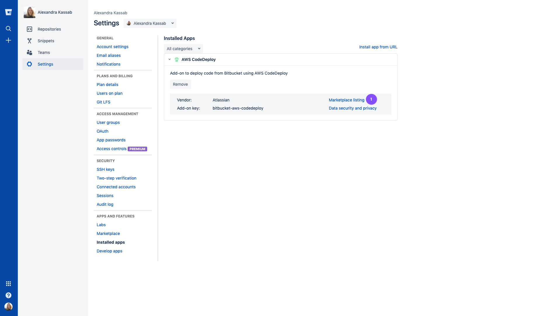

  1. Click Marketplace listing
  2. Same as step 2b above
