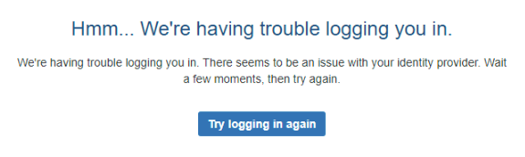

When there is a timing mismatch between the Identity Provider (IdP) and Service Provider (SP), if the timing difference is enough to fall outside the allowed time parameter, users will not be able to authenticate and log in. They will typically receive the more generic error:
“Hmm… We’re having trouble logging you in.” The page URL will should like this:
https://id.atlassian.com/error?error=access_denied&error_description=assertion%20has%20expired
Atlassian Guard "trouble logging you in"
