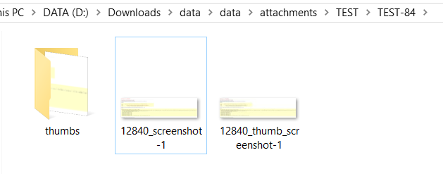

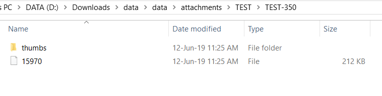

  • In older version of Jira, the attachments are named as id_filename (Jira 4.2 and earlier). However, attachments are named only with IDs on the latest version of Jira (including Jira Cloud).
  • Even after upgrading Jira to the latest version, the old attachments remain with the old formatting,id_filename
  • Example:
    • Old format:
    • New format:
