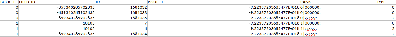

When running the database query
SELECT * FROM "AO_60DB71_LEXORANK" WHERE "TYPE" IN (0, 2);
the result should show
  • 2 rows for each Rank field in Jira
  • 2 additional rows for FIELD_ID-859340285902835 (these are for Advanced Roadmaps)
In this situation, there will be 2 additional rows for the Advanced Roadmaps FIELD_ID. A result will look similar to this:

To solve the situation, the additional marker rows need to be removed. It is recommended that the newer set of rows, which means the rows with the higher ID, be removed.
In the case of the above example, this would be the rows with the ID 1681033 and 1681035 using the following steps
