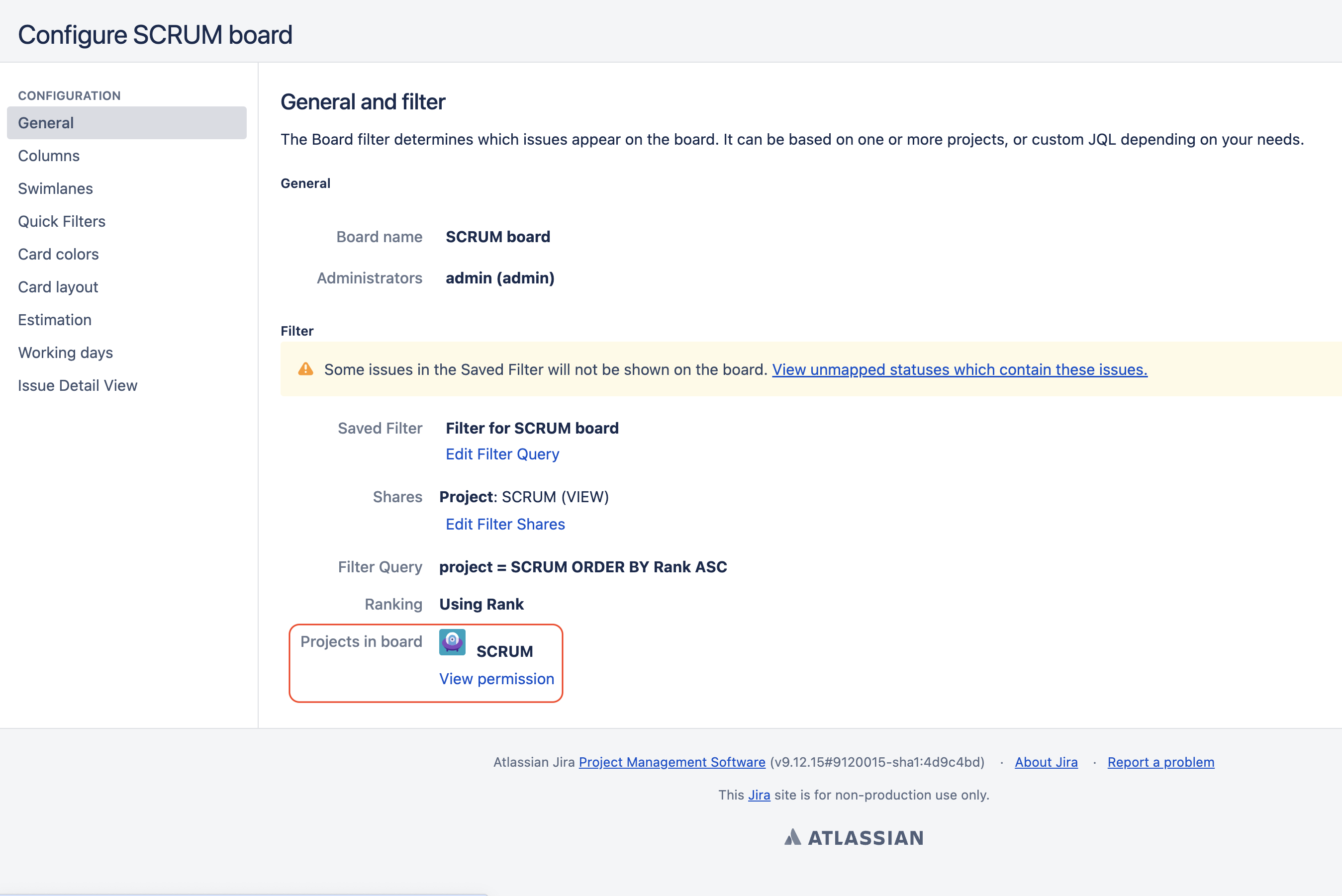

    • In case of a Board, open the Board configuration (via Board > Configure > General), and check the Projects in board section
      • This section will show the list of projects associated to the board

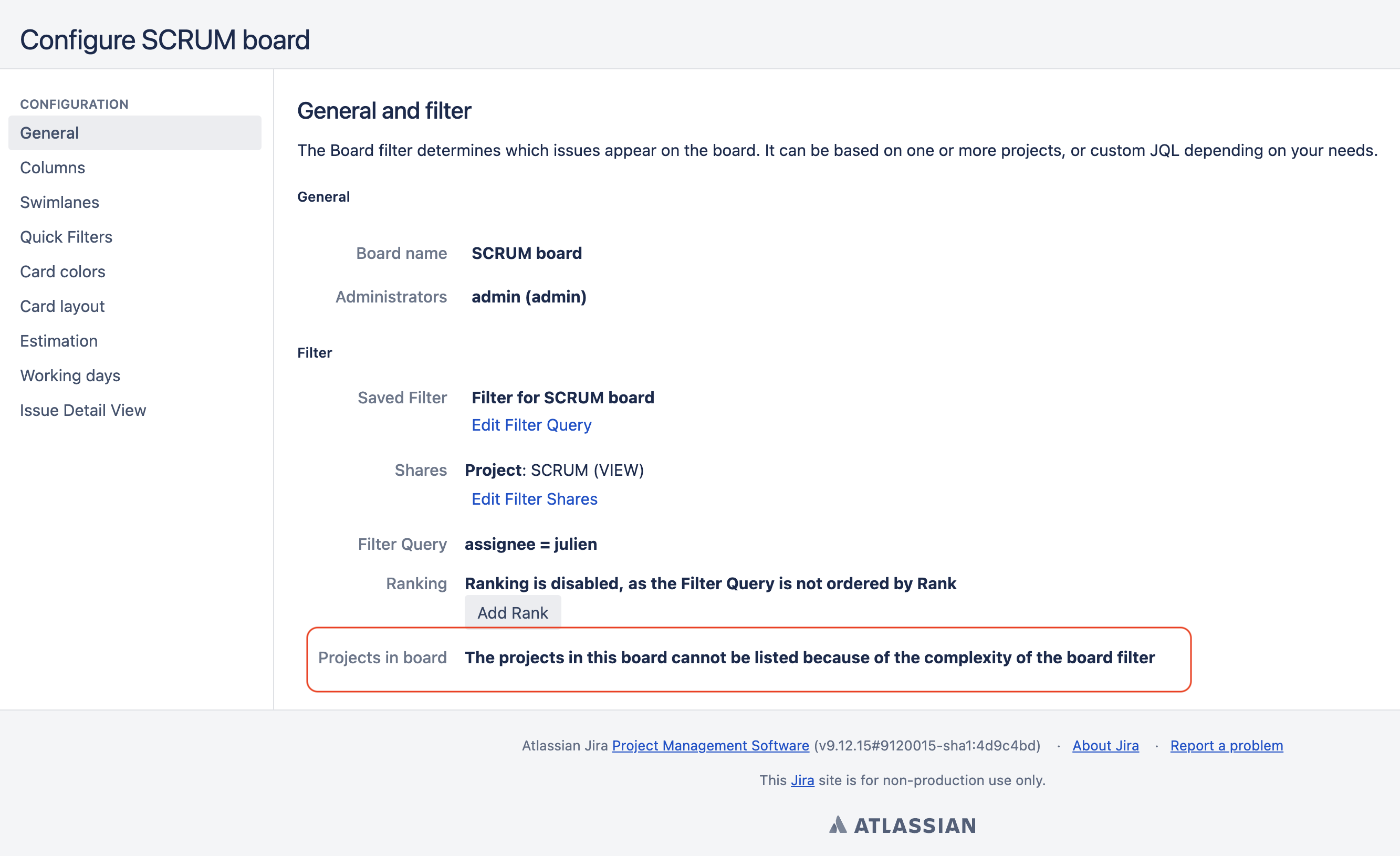

      • ⚠️ Note that if the Board filter does not explicitly filter by projects, you will get the message "The projects in this board cannot be listed because of the complexity of the board filter".
        • In such case:
          • The Plan will not be able to identify which Projects should be included in it, and it will be impossible to select any Custom Field in the Plan Scheduling configuration.
          • It will be necessary to edit the Board Filter, so that is explicitly filters issues by projects

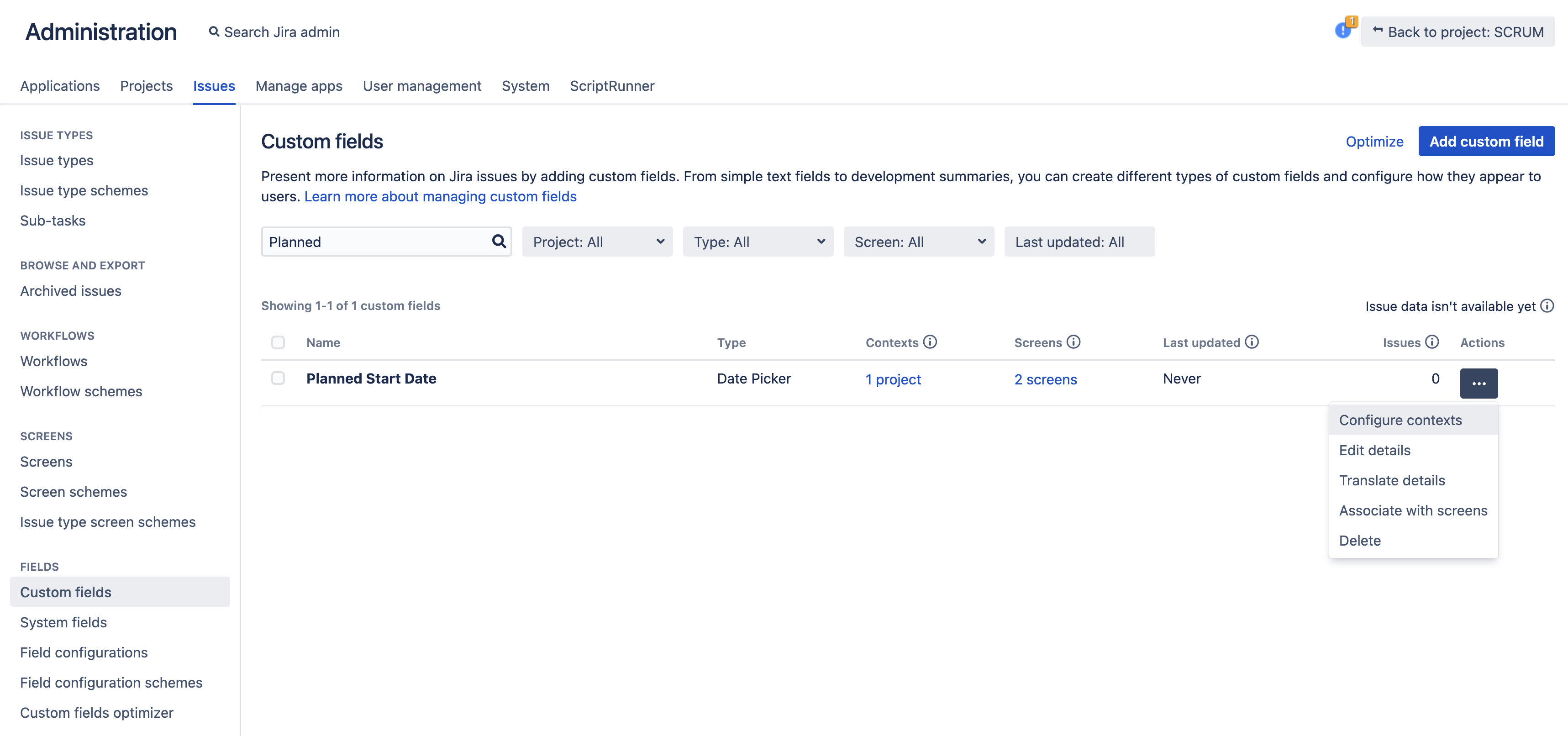

  • Go to ⚙ > Issues > Custom Fields
  • Search for the custom field of type date
  • Navigate to Actions ... > Configure Contexts
  • Take a look at the contexts configured for this Custom Field and check which issue type(s) and project (s) are associated to them.
    • In the example below, the Custom Field only has 1 Context associated to it, and this context only has 1 project (SCRUM) and 1 issue type (Story):

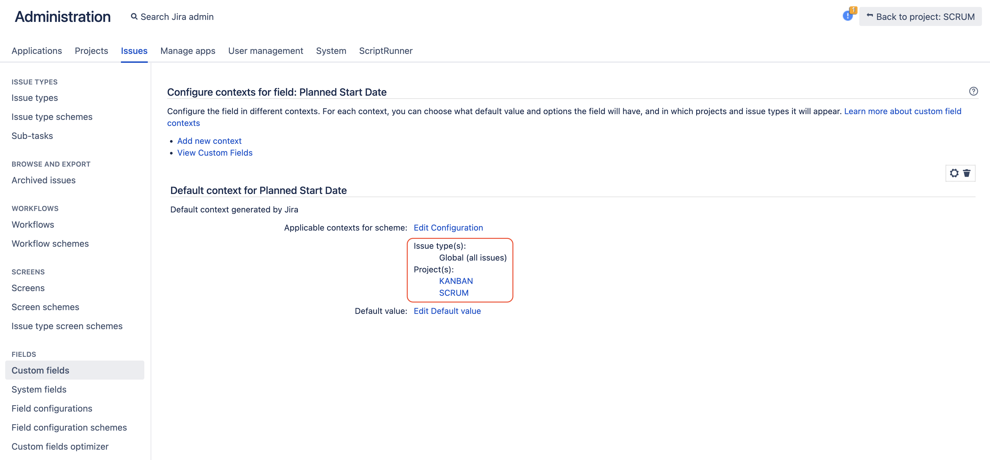

  • Fix the Context configuration by making sure to include:
    • All the Projects identified in the section Get the full list of project(s) associated to the plan
    • All the issue types
  • In the example below, the Context was changed to include the 2 projects SCRUM and KANBAN, and all issue types:

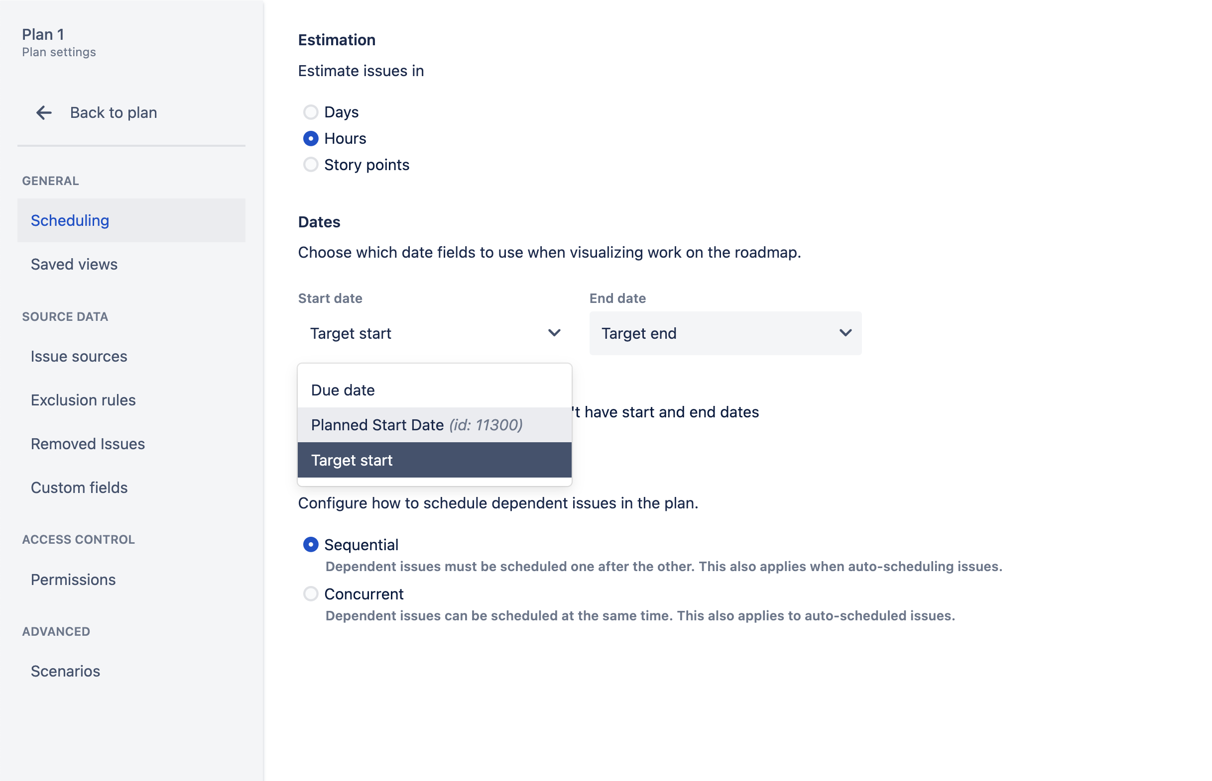

Configure the Plan Scheduling settings
Go back to the Plan Scheduling configuration, and verify that the custom field is now selectable without any error:
