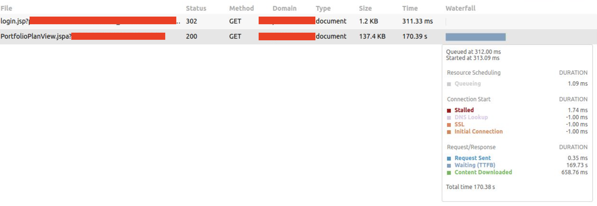

  • Users can generate the har file and check the time required to complete the request
  • In this case it is observed that request takes around 3 minute to complete. Status is 200.
