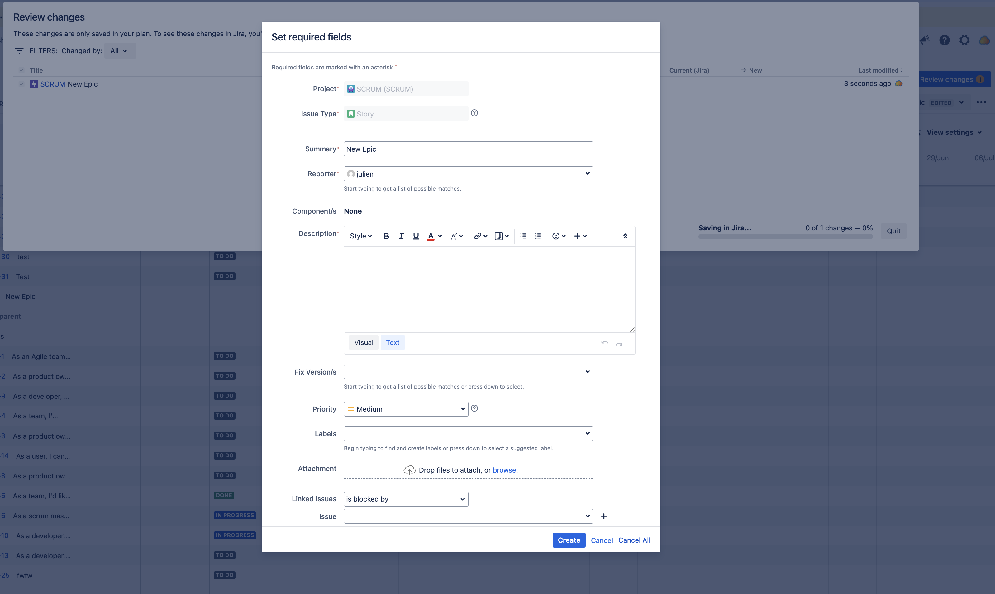

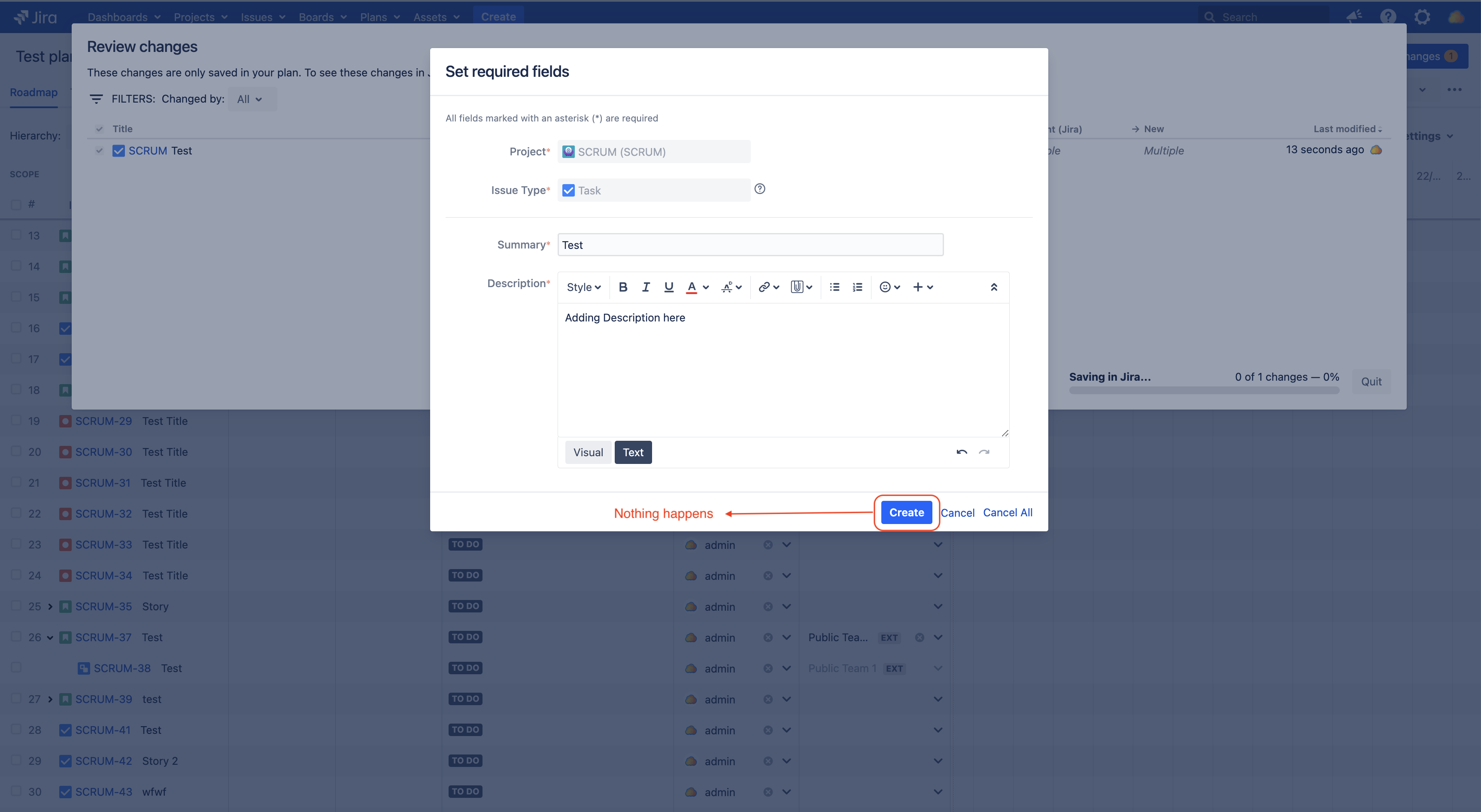

  • The Set Required Fields screen pops up after clicking on the Save selected changes in Jira button, but nothing happens when clicking on the Create button
  • The Set Required Fields screen pops up after clicking on the Save selected changes in Jira button, but the error "There is 1 error in this form" is shown when clicking on the Create button:

  • When clicking on the Create button from the Set Required Fields screen, nothing happens:
  • The Set Required Fields screen is not showing the same list of mandatory fields as in the regular Create Issue screen:
    • In the Set Required Fields screen, one of the mandatory field is missing (the Fix Version field in the example below):

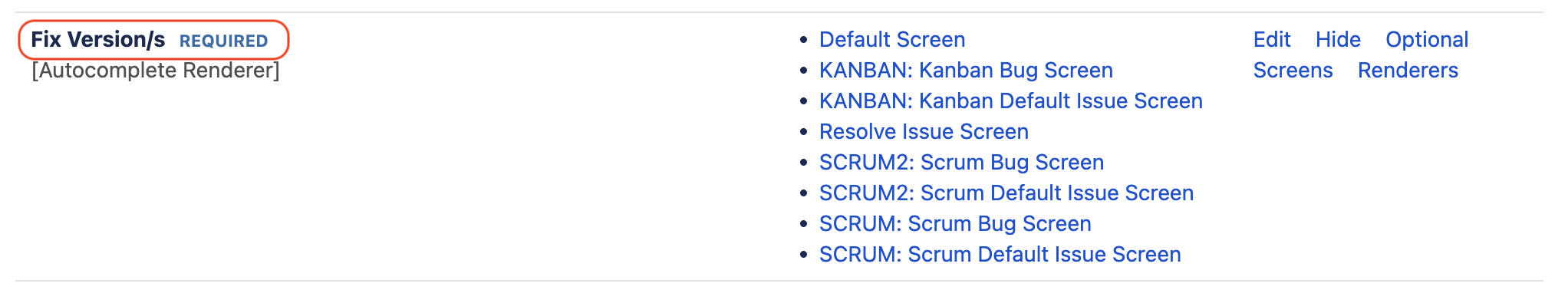

    • The Create Issue screen is showing more mandatory fields (in the example below, the Fix Version field is showing because it is required):

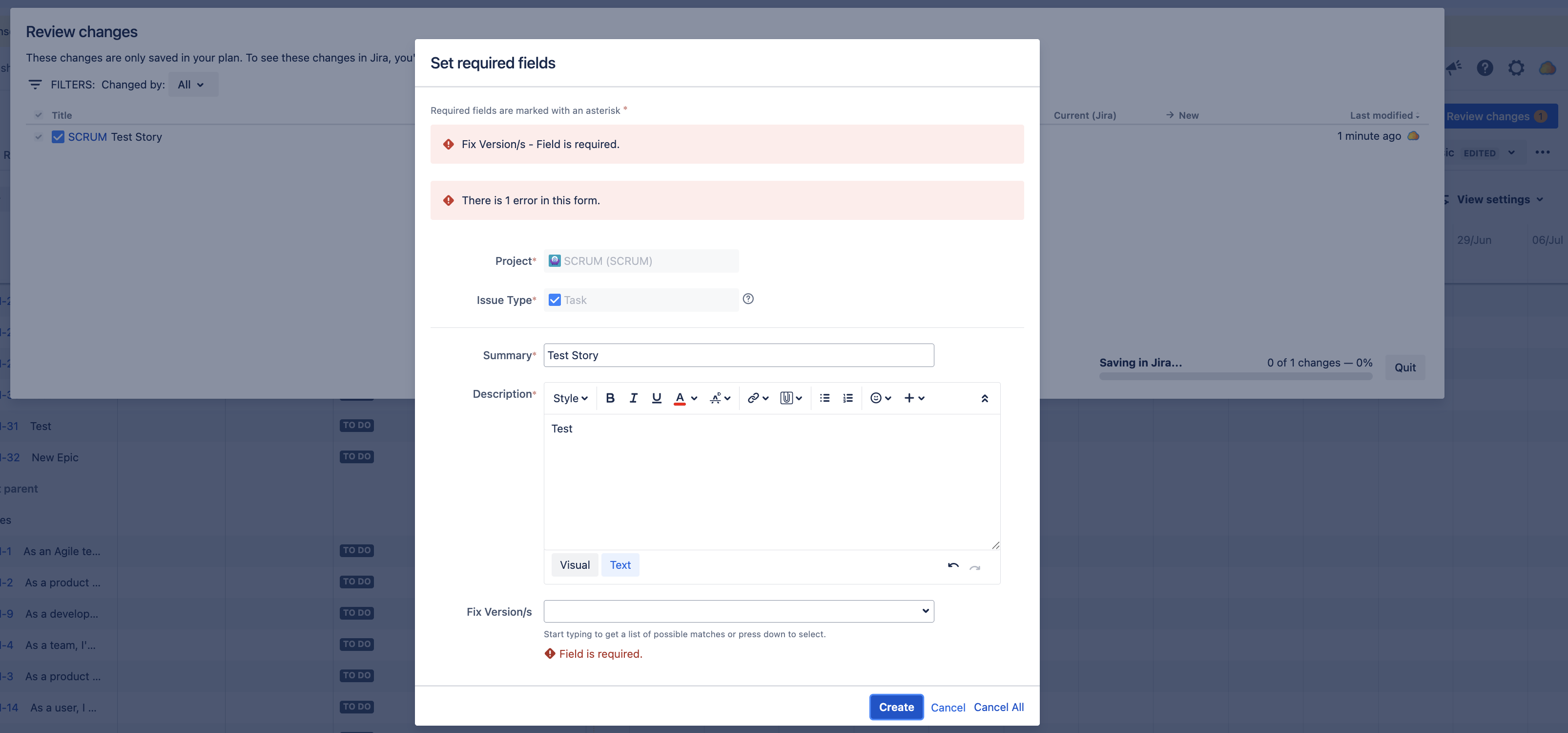

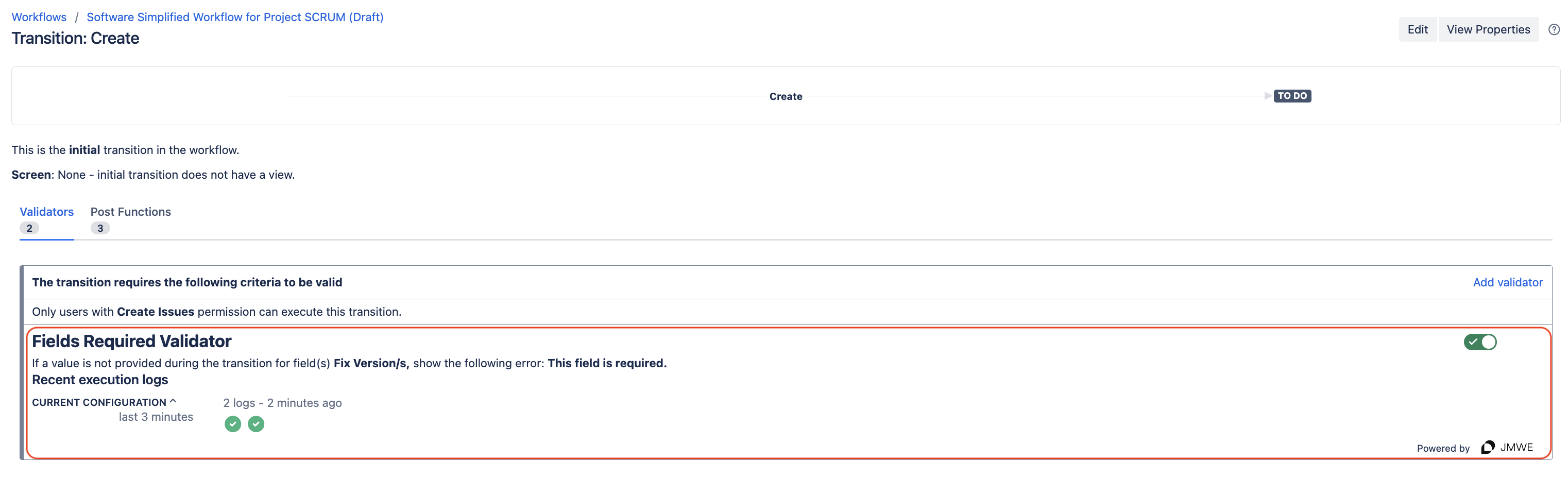

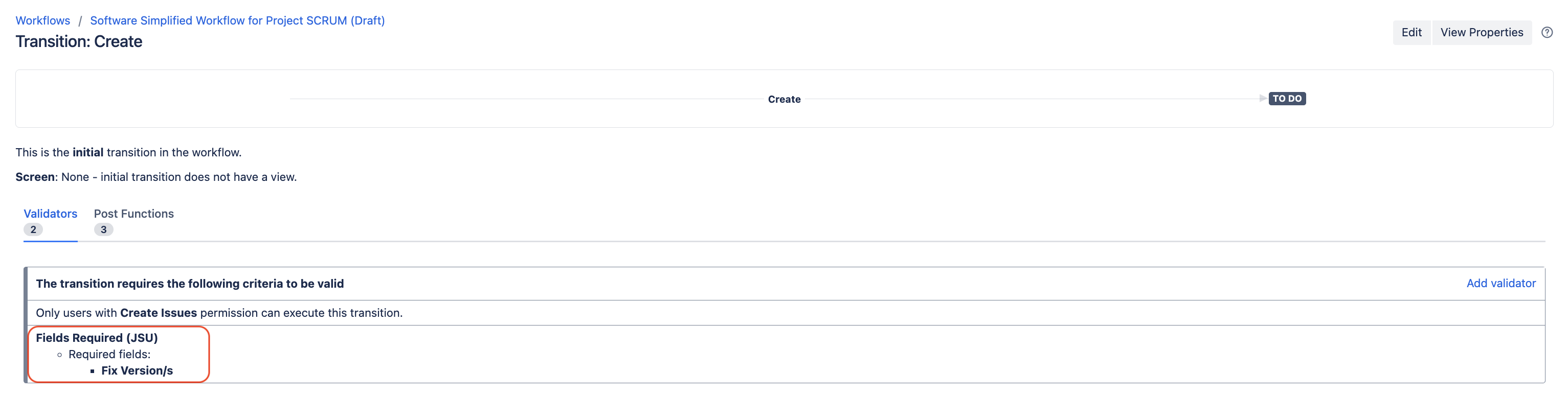

  • There is a Fields Required validator that is associated to the Create transition in the workflow used by the newly created issue

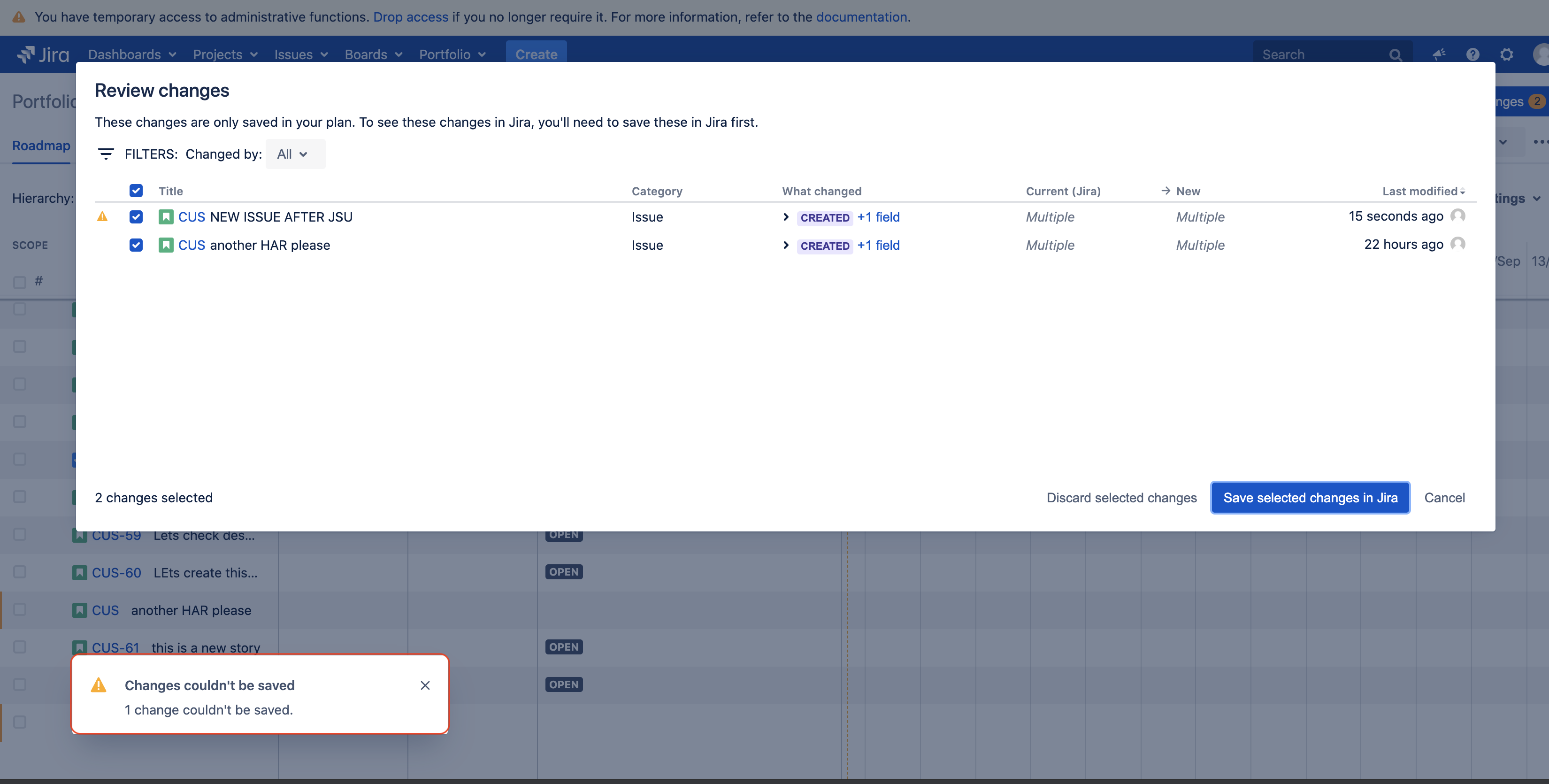

  • When clicking on the button Save selected changes in Jira, the action fails and the error "Changes couldn't be saved" pops up at the bottom left of the screen

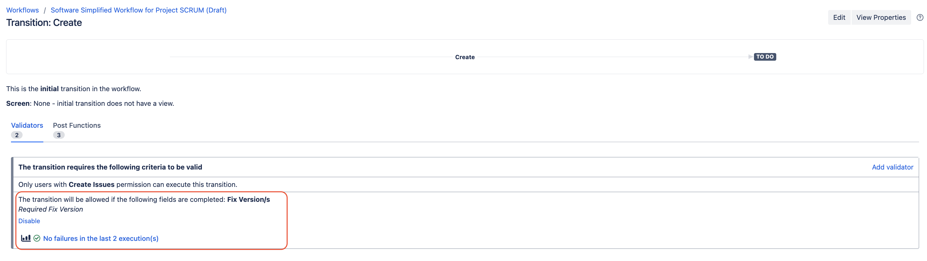

  • There is a Fields Required (JSU) validator (coming from the JSU Automation Suite for Jira Workflows add-on) that is associated to the Create transition in the workflow used by the newly created issue:

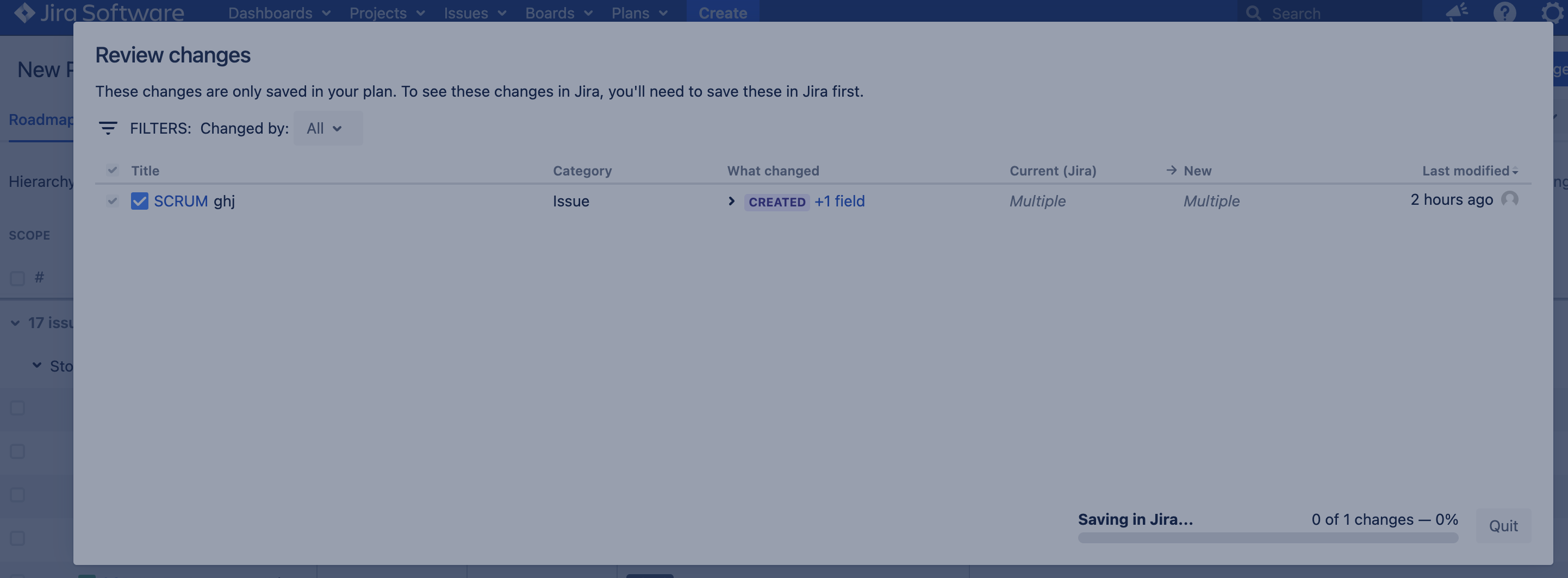

  • When clicking on the button Save selected changes in Jira, Jira hangs in the 'Saving in Jira...' progress screen:

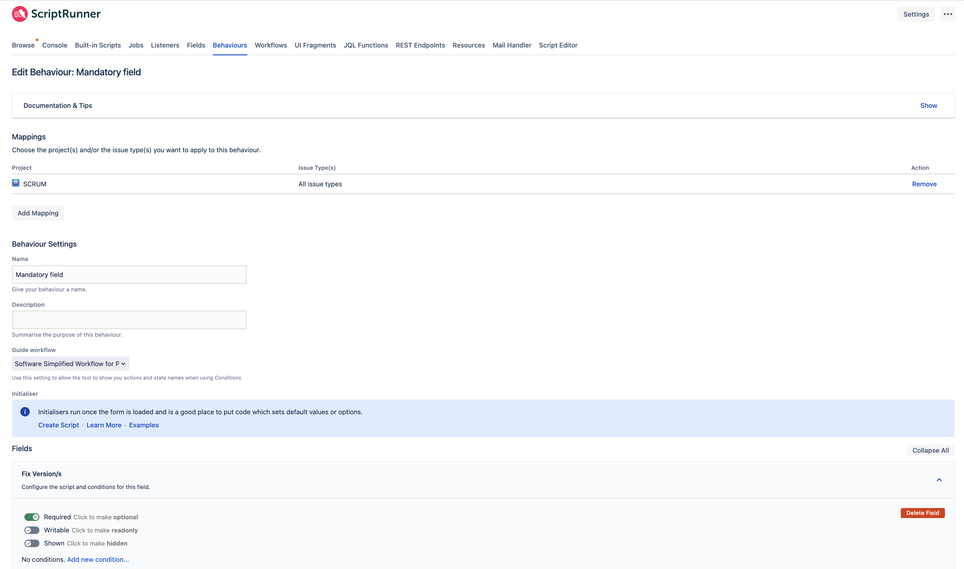

Root Cause 1
One of the field is configured as mandatory via the behaviors configuration of the ScriptRunner For Jira add-on, which is not supported by Advanced Roadmaps plans. Because of this limitation, this mandatory field is not showing in the Set Required Fields screen and as a result, the Jira application fails to create the issue since this field is mandatory but cannot be set via the UI.
This limitation is tracked in the feature request JSWSERVER-26125 - The "Set Required Field" screen does not take into account mandatory fields from ScriptRunner behaviors.
Root Cause 2
There is a Fields Required validator that is associated to the Create transition in the workflow used by the newly created issue, which is:
Such configuration is not supported by Advanced Roadmaps plans. Because of this limitation, this mandatory field is not showing in the Set Required Fields screen and as a result, the Jira application fails to create the issue since this field is mandatory but cannot be set via the UI.

The issue type is associated to a workflow that is using the "required field" validator in the 'create' transition, that is coming from the JSU Automation Suite for Jira Workflows add-on. In older Jira versions, the required fields configured by this add-on validator were not showing in the Set Required Fields screen and as a result, the Jira application would fail to create the issue since this field is mandatory but cannot be set via the UI.
This behavior was tracked in the bug ticket JSWSERVER-24900 - Issue Creation fails within the plan if workflow validators from the JSU add-on are used.
This bug was fixed in the versions 9.12.19, 9.17.5, 10.2.0.
Root Cause 4
We are facing the bug JSWSERVER-26255 - Set Required Fields screen does not show and the screen freezes when committing changes to Advanced Roadmaps Plans, which impacts:
  • Any Jira 9.12.x version from 9.12.19
  • Any Jira 9.17.x version from 9.17.5
ℹ️ Note that this bug does not impact Jira versions from 10.0.0.

Solution for Root Cause 1
Workaround 1
Instead of using ScriptRunner behaviors to make the field mandatory, make it mandatory via Jira's native Field Configuration as illustrated below:
Workaround 2
If using Jira's native Field Configuration to make a feed required is not possible (for example, it is not possible to make the Parent Link field required because it's a locked field), and you need to use ScriptRunner's behaviors instead, try this workaround.
This workaround consists in adding to the announcement banner the script mentioned in the feature request JSWSERVER-26125. This script will automatically include all the fields to the Set Required Fields screen, including the the field set as required through the ScriptRunner behavior configuration.
Solution for Root Cause 2
For this root cause, the good news is that, after the error "There is 1 error in this form" is thrown in the UI, the field set as required should appear in the Set Required Fields screen (while it was not appearing at first).
Therefore, it will be possible for the Jira user to fill in the required field in the Set Required Fields screen.
Note that there is currently no long term solution nor better workaround, since the Set Required Fields screen from Advanced Roadmaps For Jira does not support well 3rd party add-ons.
