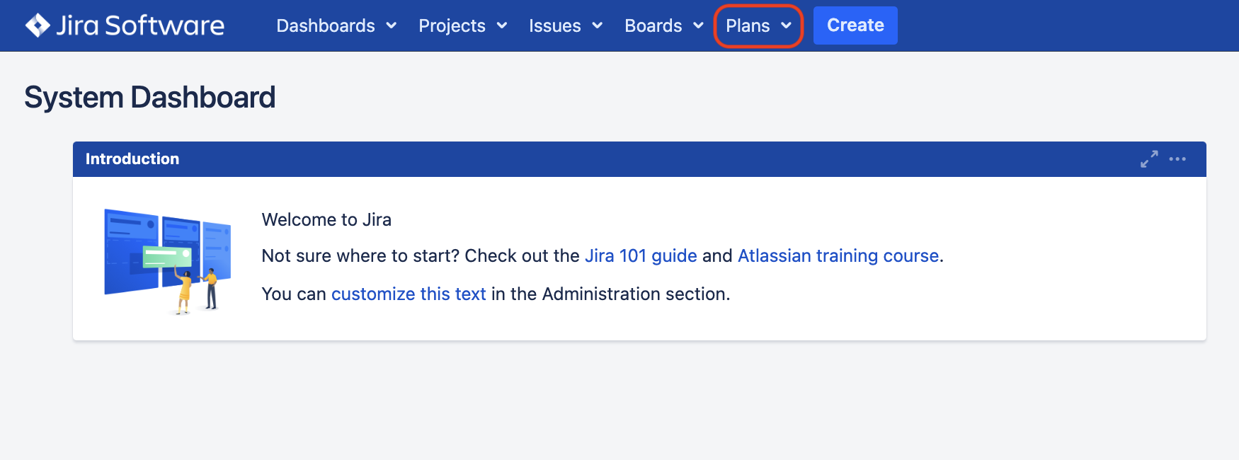

Normally, when Advanced Roadmaps For Jira is enabled, the Plans tab should be visible in the top bar menu as illustrated below:

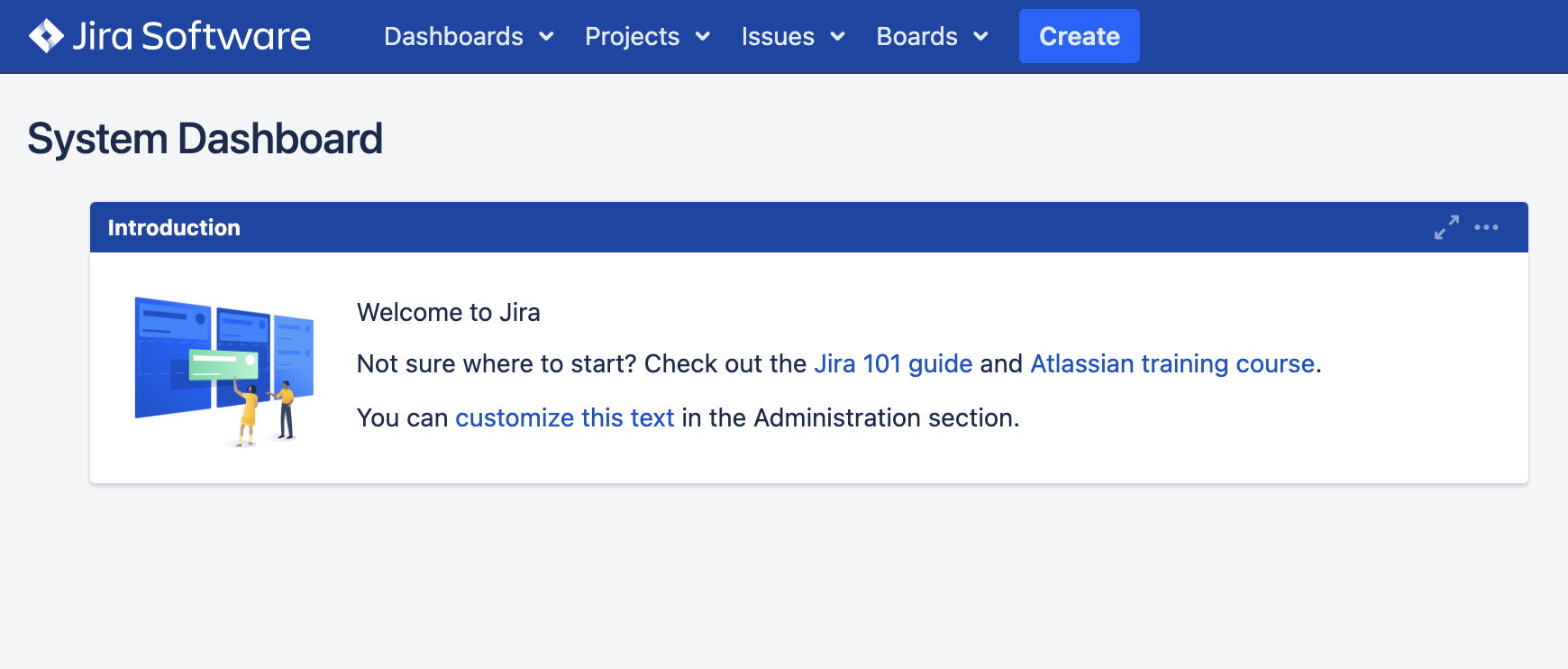

However, in the scenario described in this article, the Plans tab is missing:

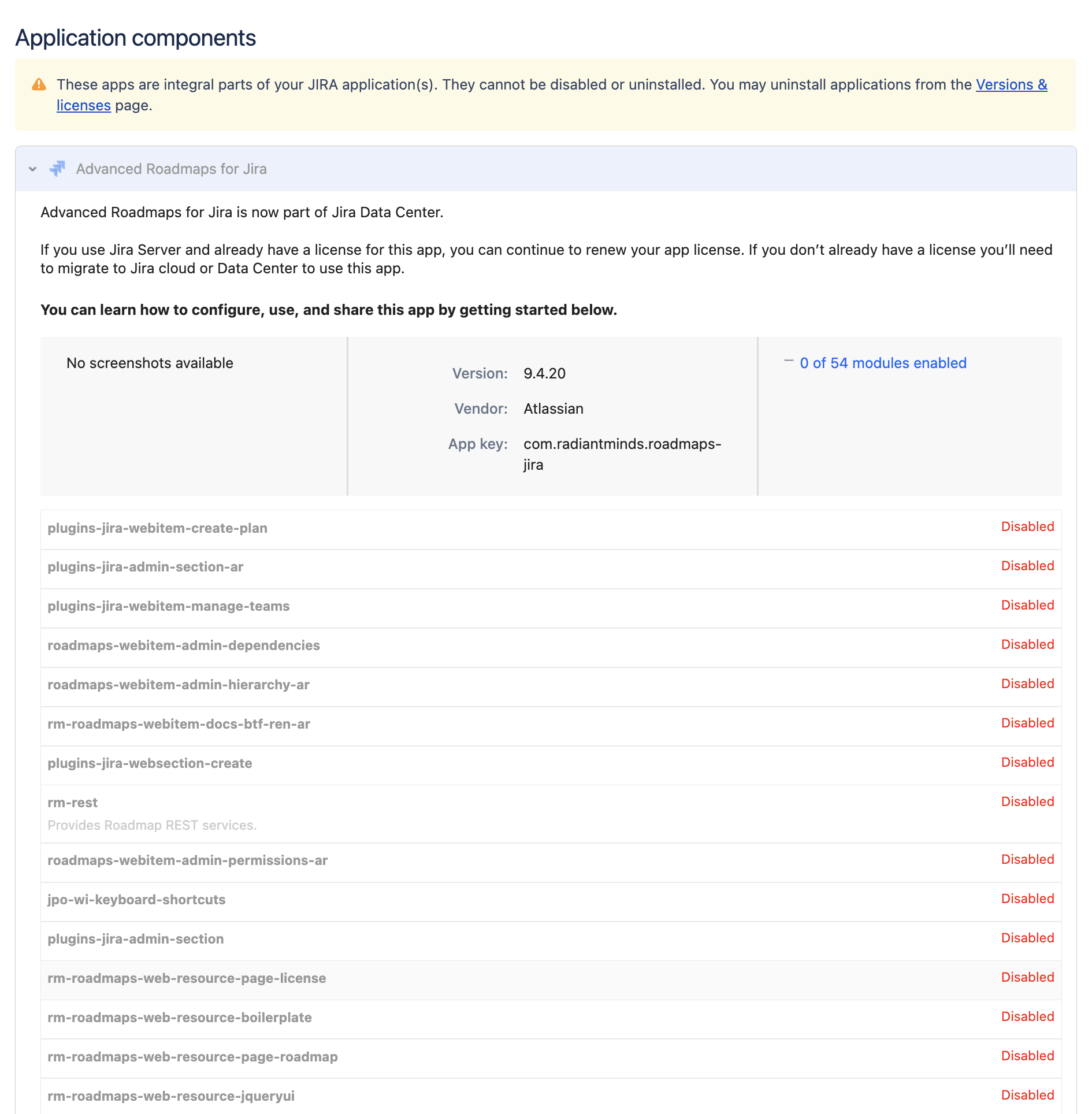

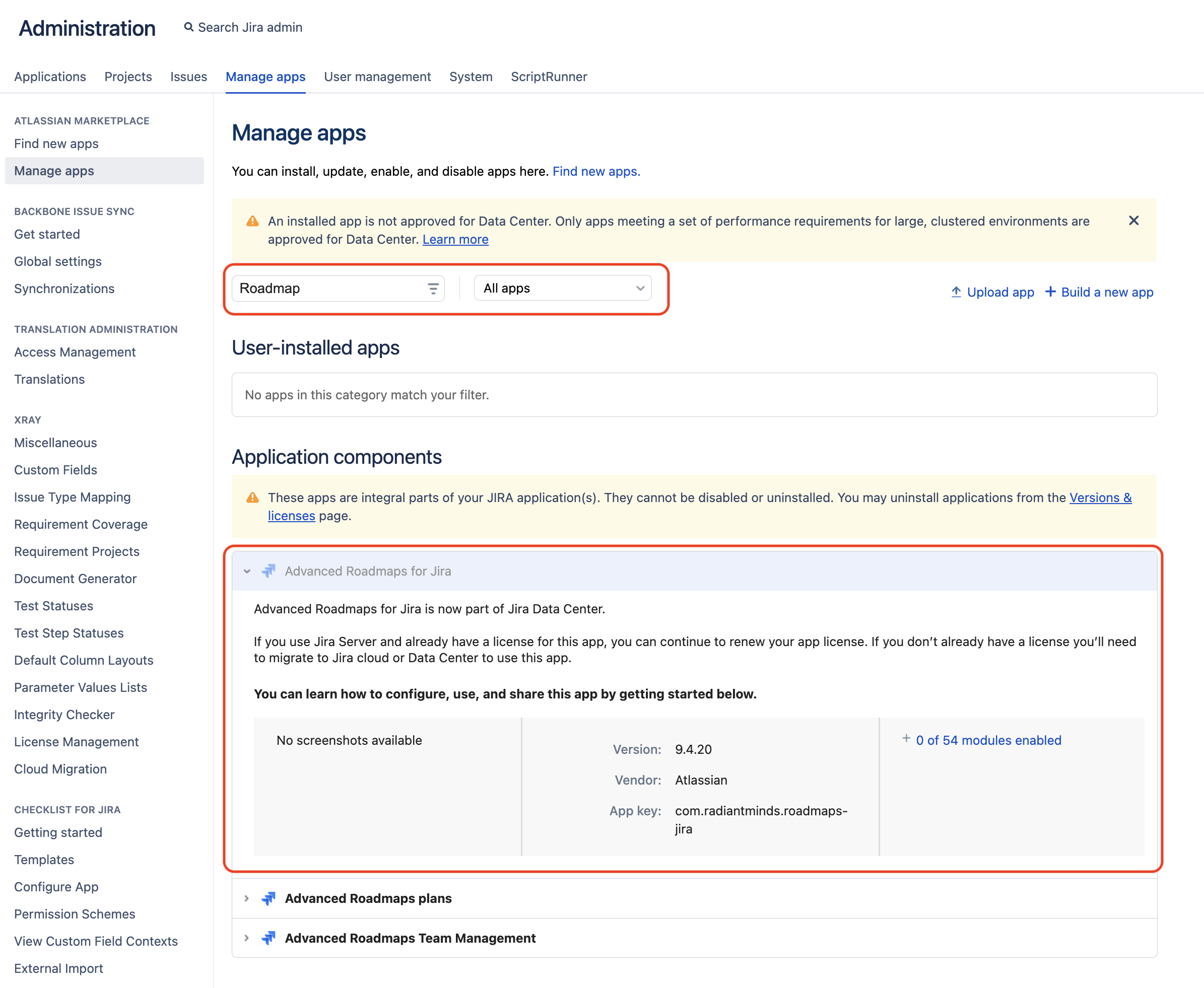

When going to the page ⚙ > Manage Apps > Manage Apps and searching for "Roadmaps" using the "All Apps" filter, we can see that the app Advanced Roadmaps for Jira is disabled:
When clicking on the link XX or YY modules enabled next to this app, we can see that all the modules are disabled and that they can't be enabled from the UI (there is no button available to enable them):
