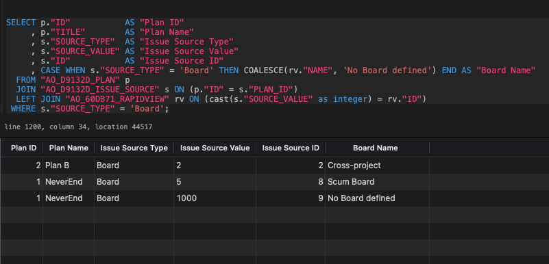

What you'll be looking for in the results of the query is any occurrences of No Board defined entries.
Those are the Plans you'll need to fix.

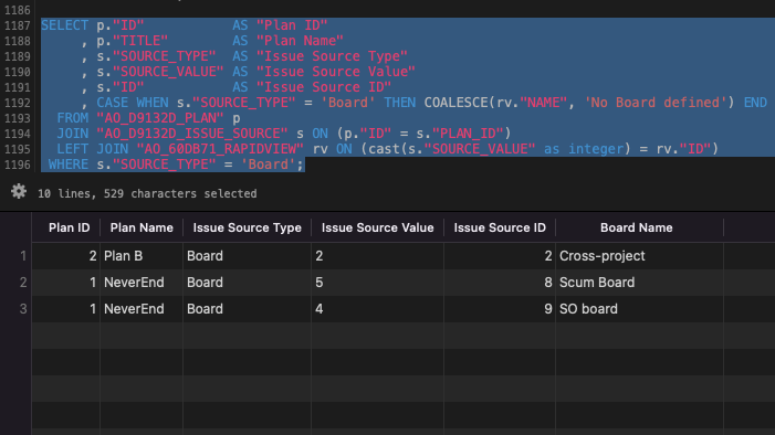

Example
In the example above:
  • Affected Plan name: in the example, Plan Name = NeverEnd
  • Affected Plan ID: in the example - Plan ID = 1
  • Issue Source Type: Board
  • Issue Source Value (that's the ID of the invalid Board): in the example, invalid Board ID = 1000
  • Board name: No Board defined - that's the invalid Board.
    • The ID is present on the AR table but is not present on the Boards table anymore (Board was deleted)
  • Issue Source ID: this is the ID we'll use for the update statement (section below), if needed. In the example, Issue Source ID = 9

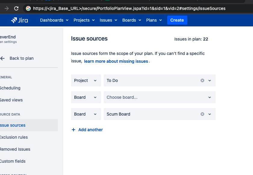

This is how the Plan would be displayed in UI
Notice the empty Board value there - that's the invalid entry.

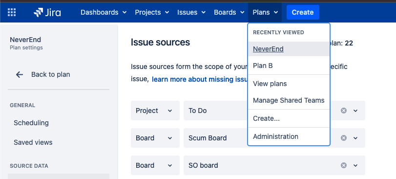

  1. To edit a Plan's issue source: go to Jira's top menu bar → Plans → Select the offending Plan from the list
    Select offending Plan from UI
  2. Click on the cog icon on the left → Click Configure
    Configure Plan

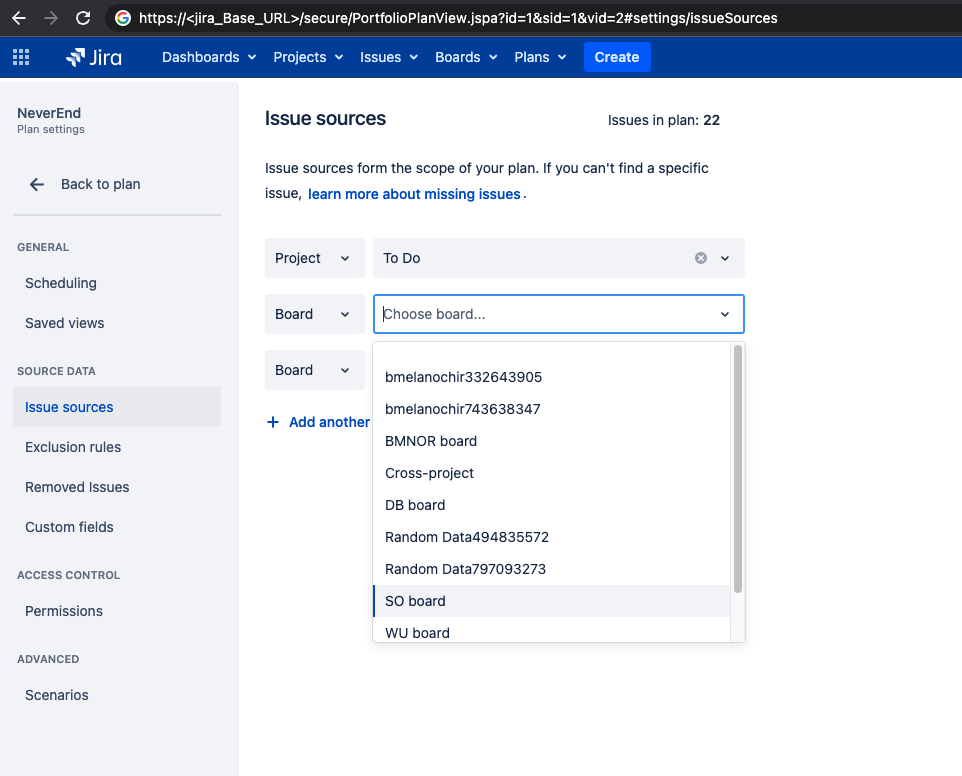

  3. Click issue sources on the left
    Configure Issue source

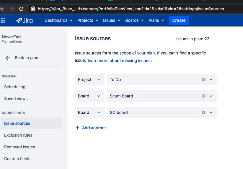

  4. Ideally, if you're able to select another Board from the dropdown menu (screenshot above), then it's all good.

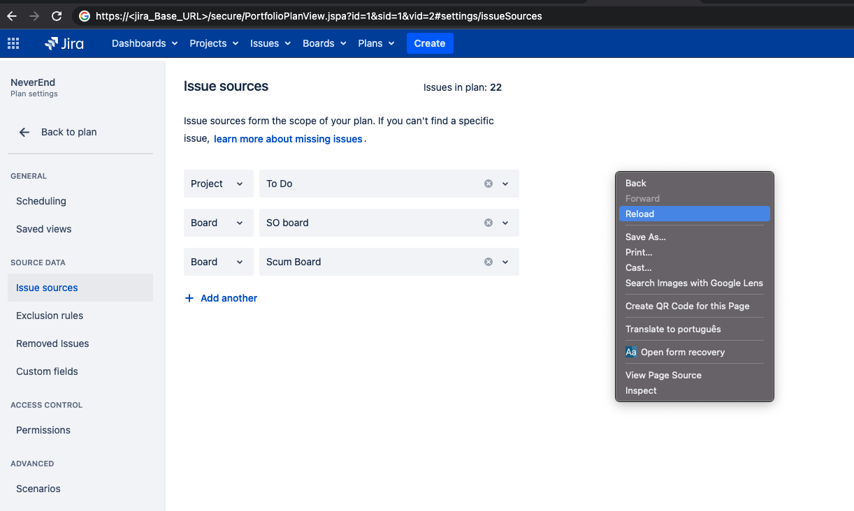

  5. Just select a new Board (the UI won't show any confirmation, just refresh it via CMD/CRTL+R to make sure the Issue Source was saved.
    Select New Board from UI
  6. That'll also allow you to remove the Board altogether from the Plan (since you added it to remove the reference to a deleted/invalid Board).
    That's so it won't affect the data displayed on the Plan.
  7. If you want to remove the Board after adding a valid one, just click the X on the dropdown menu alongside the Board entry.

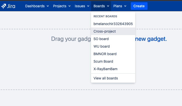

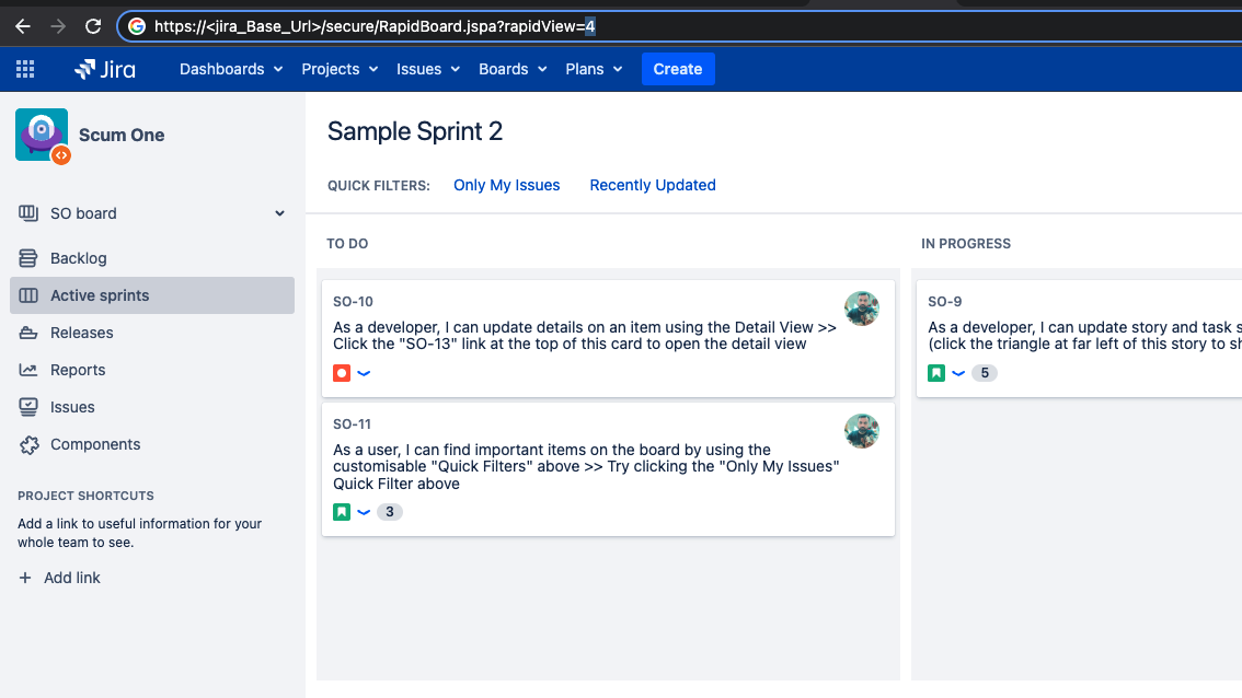

  1. Go to Jira top bar → Boards →
    Select Board from UI
  2. Select one valid Board from the list and get its ID → Select the Board → Open it →
  3. Get the ID from the URL (rapidView=<this is id>) (ID = 4 in this example screenshot) →
    Find the ID from URL

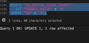

  4. Having the ID at hand, update the AR table AO_D9132D_ISSUE_SOURCE, switching the ID of the invalid Board with the ID of the Board you chose (a valid one).
  5. Make sure to use the Issue Source ID value on the update statement below (column ID of the table AO_D9132D_ISSUE_SOURCE - get its value from the SELECT query above).
    Each row on the table has a unique ID - so we'll be updating only the offending entry.
    1. PostgreSQL
    2. PostgreSQL
      UPDATE "AO_D9132D_ISSUE_SOURCE" SET "SOURCE_VALUE" = '<ID of the valid Board you chose>' WHERE "ID" = <Issue Source ID - get from the SELECT query above>;
    3. Oracle, MySQL, MSSQL server
    4. Oracle, MySQL, MSSQL Server
      UPDATE AO_D9132D_ISSUE_SOURCE SET SOURCE_VALUE = '<id of the Board you choose>' WHERE ID = <Issue Source ID - get from the SELECT query above>;
  6. Execute the update statement:
    Update Query Execution
  7. Confirm you now have a valid Board ID on the Plan's Issue Source:
    Confirm the changes from DB
  8. And confirm on the UI also:
    Confirm the changes from UI
