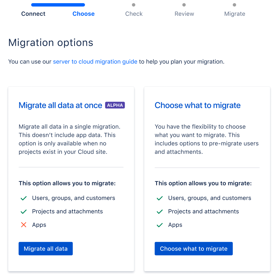

5.b. Migration options
The Jira Cloud Migration Assistant now supports ‘all data at once’ migrations, in addition to the existing project-by-project migration capability. For more information on this announcement, read our Community post.
Migrate all data at once
With this first release (Alpha), you can migrate all data in a single migration. This doesn’t include app data. You can only use this option when no projects exist in your Cloud site.
Choose what to migrate
You have the flexibility to choose what you want to migrate. This includes options to pre-migrate users and attachments. This takes you to the ‘Choose your migration options’ screen.
Recommendation about migration options
  1. If you’re planning to pre-migrate data, for example, users and attachments, we recommend you:
    1. First, select the migration option Choose what to migrate. This gives you the flexibility to choose what you want to migrate, including options to pre-migrate data.
    2. After you’ve pre-migrated data, select the migration option Migrate all data at once to migrate all your data in a single migration.
      1. The Migration Assistant won’t re-migrate users but it will link project data to the email addresses in Cloud.
      2. The Migration Assistant will recognize any attachments that have already been migrated and skip over these. It will still migrate new attachments, and also remove the links for any attachments that have been deleted.
Migration options: migrate all data or choose what to migrate
