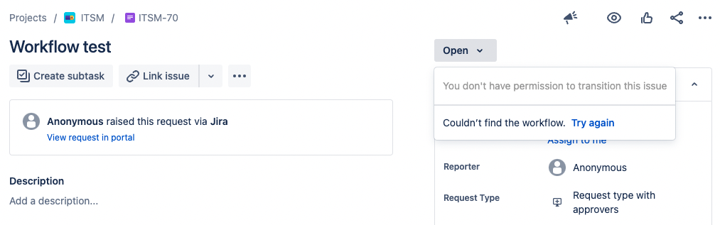

When trying to transition to another status, it will show You don't have permission to transition this issue and it's also not possible to view the workflow.

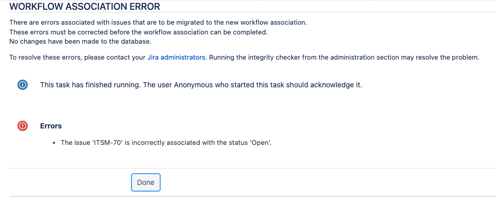

If we try to manually change the Issue type in order to try to associate with the correct workflow, it won't work and the following error will return:
  • The issue 'KEY-123' is incorrectly associated with the Status 'Status-name'
  • This task has finished running. The user Anonymous who started this task should acknowledge it.

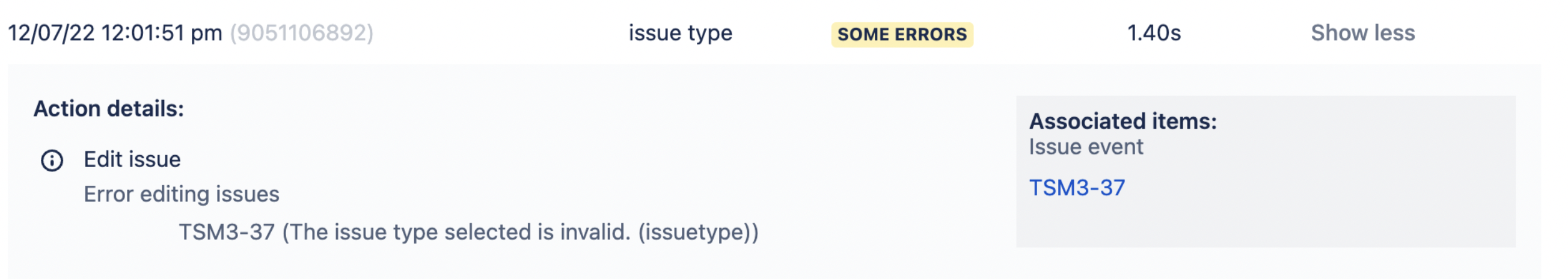

Recently, a fix to the bug above was implemented and Automation rules that would change the Issue type of tickets where the Workflow and/or Field configuration was different, would fail with the error:
1 (The issue type selected is invalid. (issuetype))
The fix for the bug was temporarily disabled so everyone that was facing the error in Automation can adjust the Workflow and Field configuration on the projects.
Once the fix is deployed, the Automation will only change the Issue type of a ticket if the destination Issue type has the same Workflow and Field configuration.

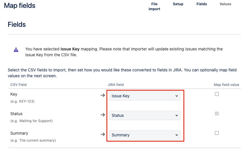

After that, it's necessary to go to Cog icon > System > External System Import > CSV.
Select the file > Next > Select the affected project > Next.
On the Map fields screen, it's necessary to search and select the fields as the example below so the affected ticket (or tickets) can be correctly updated.
On the next screen, select the Status > Begin import.

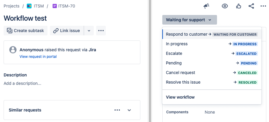

After that, when accessing the affected ticket, we can see that the ticket has the correct status, and to confirm that the ticket is associated with the correct workflow, we can just click on View workflow in order to check its name.
If it still shows a different name, then manually change the Issue type to make sure it will be mapped to the correct workflow.

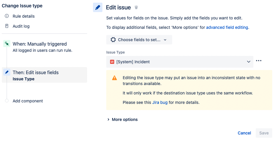

Solution 2:
Use an Automation rule to change to the previous Issue type.
By using this option, it's possible to then manually change the Issue type to the desired one.
This option is helpful in cases where the tickets are always created on a specific Issue type, so from the affected ticket you can execute the rule to fix the inconsistency.
Create a simple automation rule using the Manual trigger and the action to change the Issue type.
This solution will only work while the bug is not fixed. After the bug fix, for any inconsistency with the workflow, only Solution 1 can be used.
