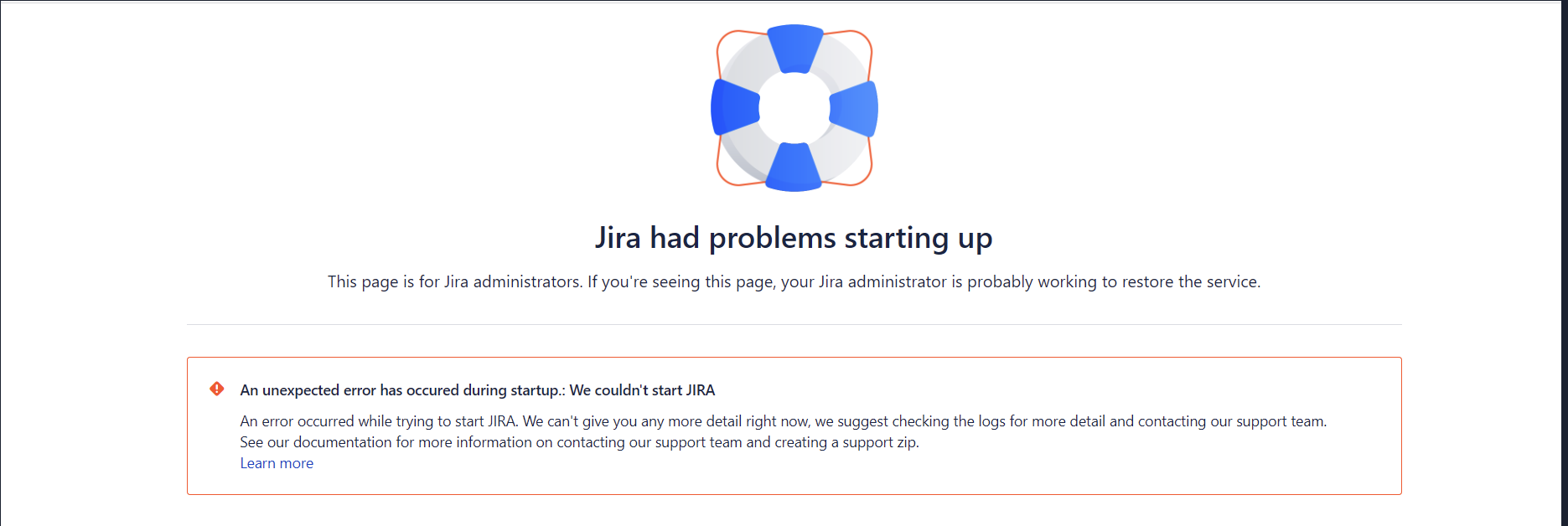

After upgrading from Jira release version 8 to Jira 9, Jira is unable to start, the following post-upgrade screen is displayed with no further details on why Jira is unable to start:
