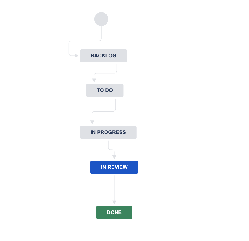

This situation may arise if there is no transition between the source and destination statuses. For instance, if Column A has two associated statuses (such as To-Do and In Progress) and Column B has only one (e.g., In Review), issues in the To-Do status cannot be moved from Column A to Column B via drag-and-drop if there is a transition from IN PROGRESS to IN REVIEW but not from To-Do to IN REVIEW. This is because there is no existing transition between these two specific statuses.

Go to the workflow associated with the project (Project Settings-->Workflow).
Create a global transition for the target status, allowing incoming transitions from any existing status in the workflow.
Publish the changes made to the workflow.
This should enable drag-and-drop operations to function properly, as the target status now permits transitions from all workflow statuses.
Option 2:
Access the Board settings and go to Column Configuration.
Add a new column with the subsequent status mapped to it, ensuring that transitions exist. (For example, create a separate column with the "In Progress" status mapped to it so that issues can be dragged from the "To Do" column to the "In Progress" column and then from the "In Progress" column to the "In Review" column.)
