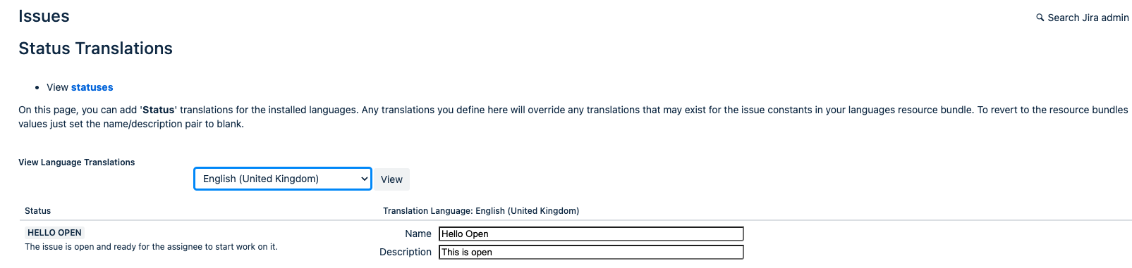

For the status Open, consider the admin has set the translated Name and Description for the language English (United Kingdom)

The API results are fetched according to the language set by the user under Account settings on id.atlassian.com.
Solution
Set the language under Account settings on id.atlassian.com  to English (United Kingdom) and run the API call to note that the translated name and description are returned.
{ "self": "https://ursite..atlassian.net/rest/api/3/status/1", "description": "This is open", "iconUrl": "https://ursite.atlassian.net/images/icons/statuses/open.png", "name": "Hello Open", "untranslatedName": "Open", "id": "1", "statusCategory": { "self": "https://ursite..atlassian.net/rest/api/3/statuscategory/2", "id": 2, "key": "new", "colorName": "blue-gray", "name": "To Do" } },
The UI also respects the language settings, displaying the field's name and description based on the translation set for that language.
