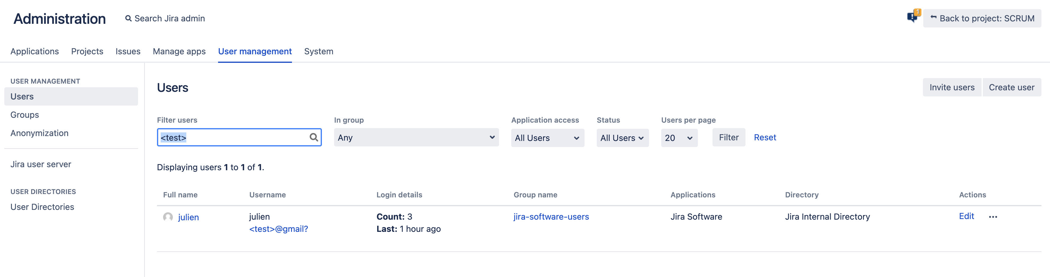

Go to the page ⚙ > User Management > Users and search for the email address identified in the logs
  • If you find a matching user (=user associated to the problematic address), then Root Cause 1 is relevant, and you came move to the Solution for Root Cause 1 section
  • If you don't find any match, move on to the Diagnosis for Root Cause 2 section.

There is a Jira user who is associated with an invalid email address. This might happen due to various reasons:
  • the user was manually created via the UI via the page ⚙ > User Management > Users with an invalid email address format
  • Jira is configured to sync users from an LDAP directory, and the LDAP directory has a user with an invalid email address format
Example of an invalid user found in the UI:

Log into Jira as an System Admin user and fix the invalid user as per either of the step below:
  • If the user comes from Jira's internal directory or an LDAP directory configured with read/write permissions, manually edit this user's email address via the UI
  • If the user comes from an LDAP directory configured without read/write permissions, you will need to fix the email address on the LDAP side, and then sync Jira with this LDAP
