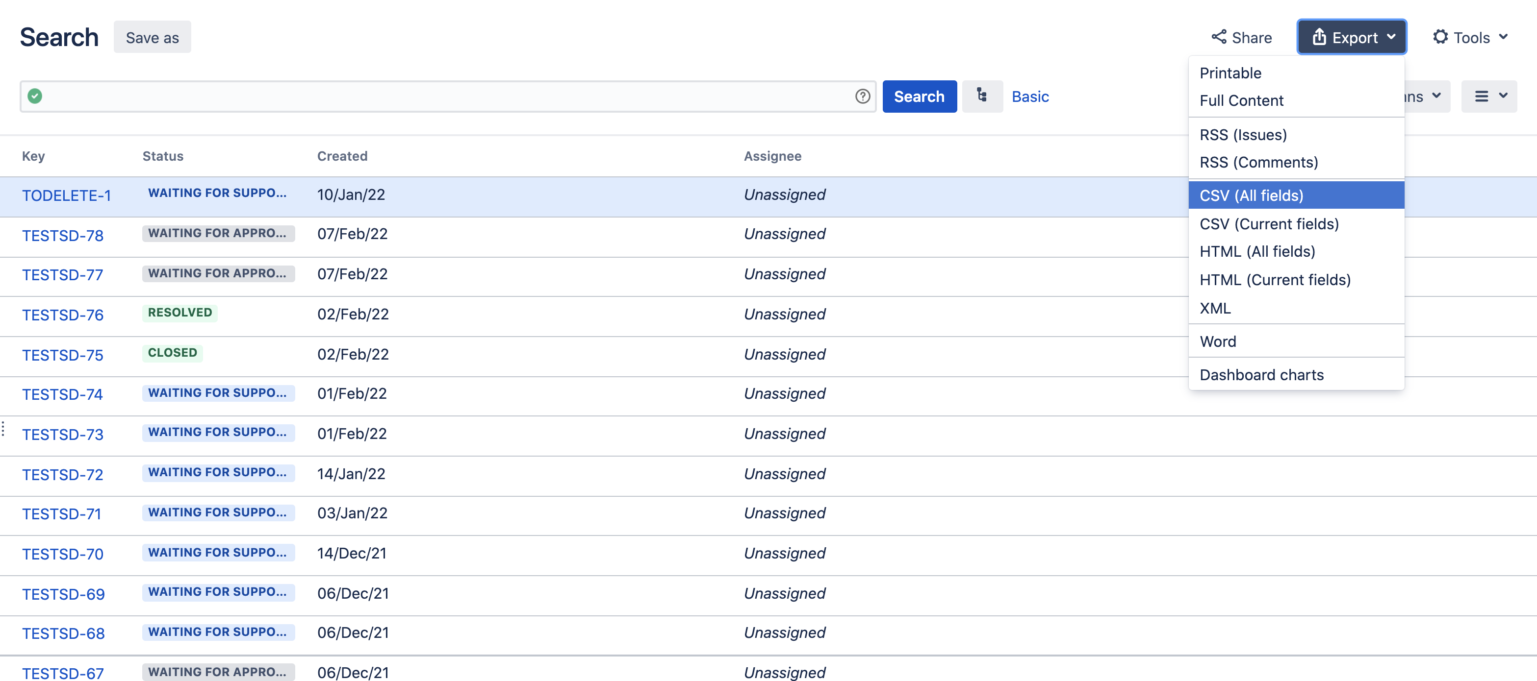

The CSV export from the Jira issue search page results in an empty file when the number of results from the search is high (for example, several thousand issues).
The problem is more likely to occur when choosing the option Export > CSV (All fields), as shown in the screenshot below:
