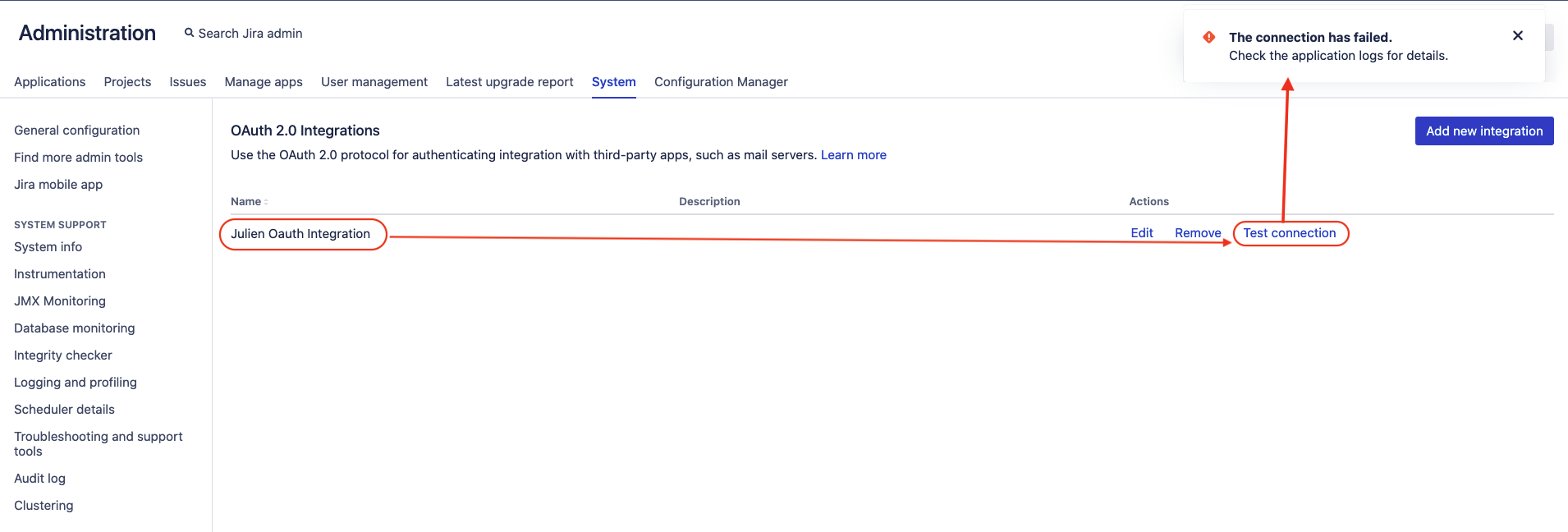

The connection test of the OAuth 2.0 integration fails with the error "The connection has failed. Check the application logs for details."
Platform Notice: Data Center Only - This article only applies to Atlassian apps on the Data Center platform.
Note that this KB was created for the Data Center version of the product. Data Center KBs for non-Data-Center-specific features may also work for Server versions of the product, however they have not been tested. Support for Server* products ended on February 15th 2024. If you are running a Server product, you can visit the Atlassian Server end of support announcement to review your migration options.
*Except Fisheye and Crucible
Summary
After configuring an OAuth 2.0 integration in ⚙ > System > OAuth 2.0, when clicking on the Test connection button, the error "The connection has failed. Check the application logs for details." is thrown in the UI:

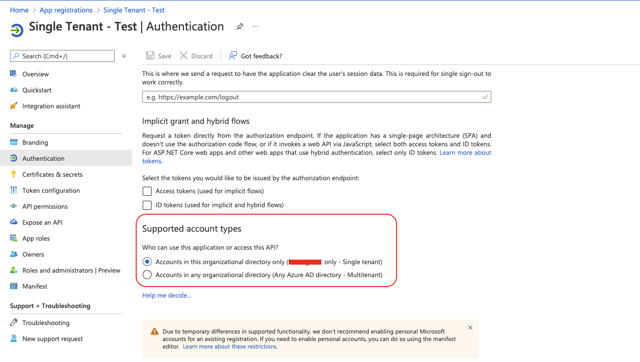

Root Cause 1
When configuring an OAuth 2.0 integration with the default values provided by Jira for the 2 fields Authorization endpoint and Token endpoint, we recommend using the support account type of the application needs to be set to Accounts in any organizational directory (Any Azure AD directory - Multitenant) and personal Microsoft accounts (e.g. Skype, Xbox).
If the support account type is set to "single-tenant", then the connection test will fail with the default values for the field Authorization endpoint and Token endpoint.
If your organization only allows the "single-tenant" support account type, then it will be necessary to change the 2 fields Authorization endpoint and Token endpoint in the OAuth 2.0 configuration page. Please refer to the section Solution for Root Cause 1.

Diagnosis for Root Cause 1
  • If you find the following error the Jira application logs, then the Root cause 1 is relevant:
    2021-11-16 12:35:50,956+0100 https-jsse-nio-8443-exec-7 ERROR julien 755x4397x2 lyskqh 127.0.0.1 /rest/oauth2-client/latest/config/flow/d4ec2ed5-fa07-4e3d-948d-0ce99fb20a40 [c.a.o.c.rest.resource.ClientConfigurationResource] Error occurred while authorizing an integration. The error message is: Error when fetching authorization response: {"error_description":"AADSTS50194: Application '79c86cf8-e761-4fdc-bc20-a629c5d04260'(Single Tenant - Test) is not configured as a multi-tenant application. Usage of the \/common endpoint is not supported for such applications created after '10\/15\/2018'. Use a tenant-specific endpoint or configure the application to be multi-tenant.\r\nTrace ID: d7599cf0-813f-4495-8317-577479857f00\r\nCorrelation ID: 34687097-cd9a-4300-9639-b561f5effd26\r\nTimestamp: 2021-11-16 11:35:47Z", "error":"invalid_request"}
  • Log into the Azure portal (https://portal.azure.com/), go to App Registration > Select application > Authentication, and check the Supported Account Types setting. If it is set to Accounts in this organizational directory only (XXXXXX only - Single tenant), then Root cause 1 is relevant:

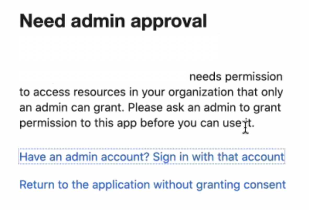

Diagnosis for Root Cause 5
If you see the following error coming from Microsoft after logging into the Microsoft portal (and after clicking on the Oauth 2.0 Test Connection button), then the Root Cause 5 is relevant:
needs permission to access resources in your organization that only an admin can grant. Pease ask an admin to grant permission to this app before you can use it

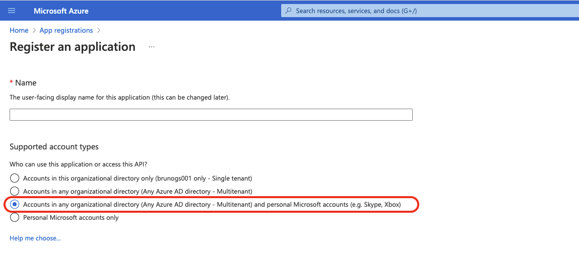

If your organization allows the "multi-tenant" support account type
Go to the Azure Admin UI, and either edit the current application, so that the supported account type is set to "multitenant", or create a new application by making sure to select the type Accounts in any organizational directory (Any Azure AD directory - Multitenant) and personal Microsoft accounts (e.g. Skype, Xbox):
Follow the steps below:

Solution for Root Cause 5
Ensure that the user who logged into the Microsoft Portal while testing the Oauth 2.0 integration has the right permission to authorize this integration. For assistance on this matter, please reach out to your Azure administrator.
