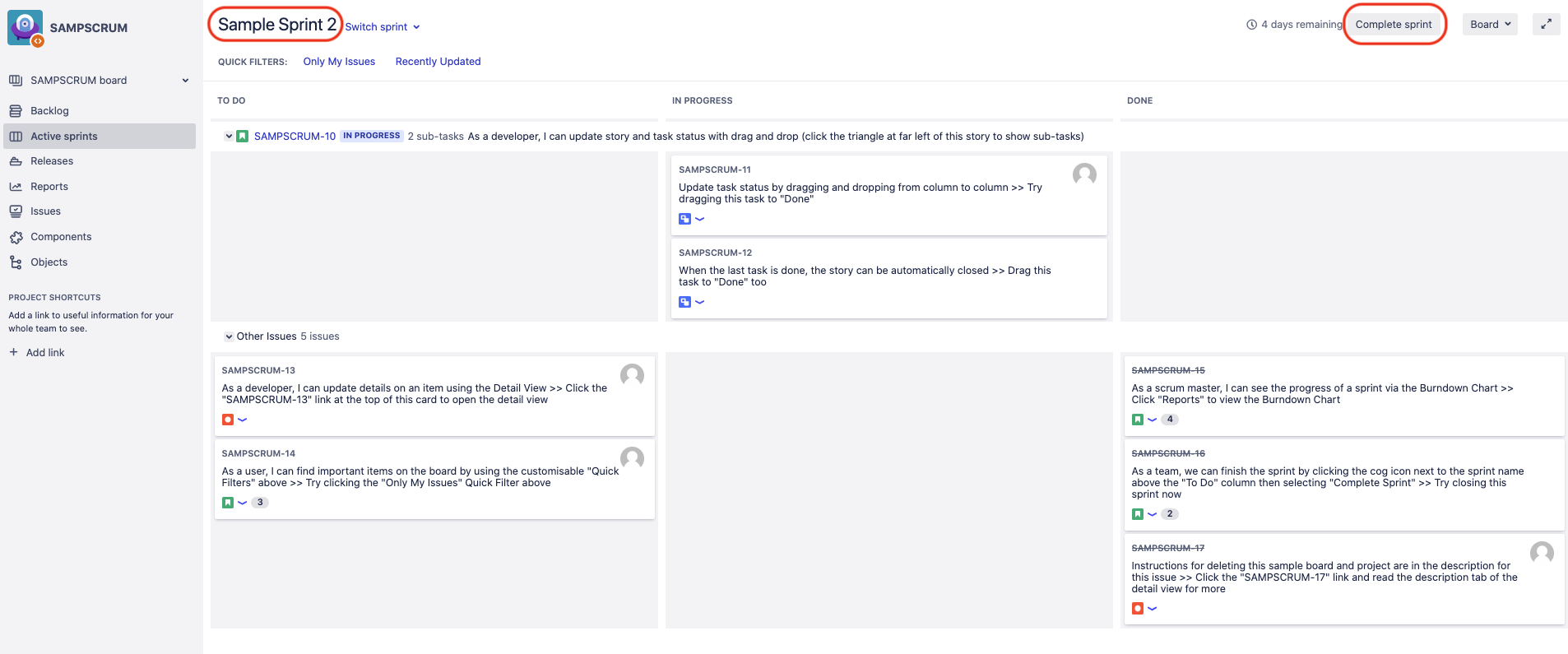

Solution
To be able to complete the Sprint, you will need to go to the Active Sprints page. The Complete Sprint button will be visible there:

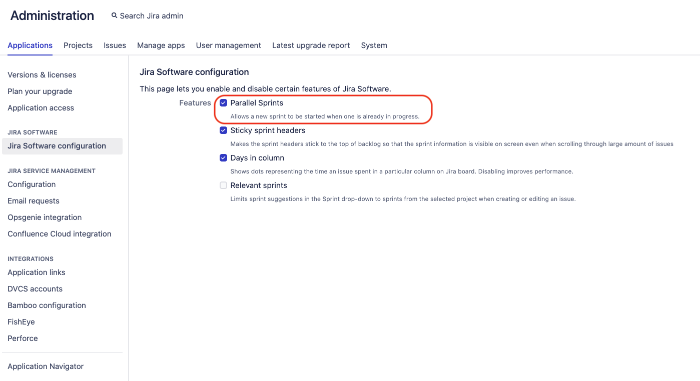

Scenario 2
In Jira Software, it is possible to run multiple Sprints in parallel in the same Agile board if the setting "Parallel Sprints" is enabled in ⚙ > Applications > Jira Software Configuration, as explained in the documentation Using Parallel Sprints:

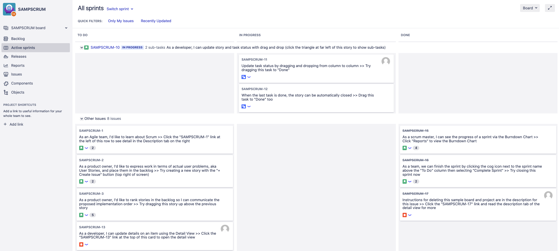

If multiple Sprints are started in parallel, when going to the Active Sprints page, the Complete Sprint button will be missing:
Root Cause
This behavior is expected by design in case there are multiple Sprints running in parallel. When going to the Active Sprints page, no Sprint is selected by default. Instead, All sprints will be shown in the UI. If no specific Sprint is selected, the Complete Sprint button will not be shown.

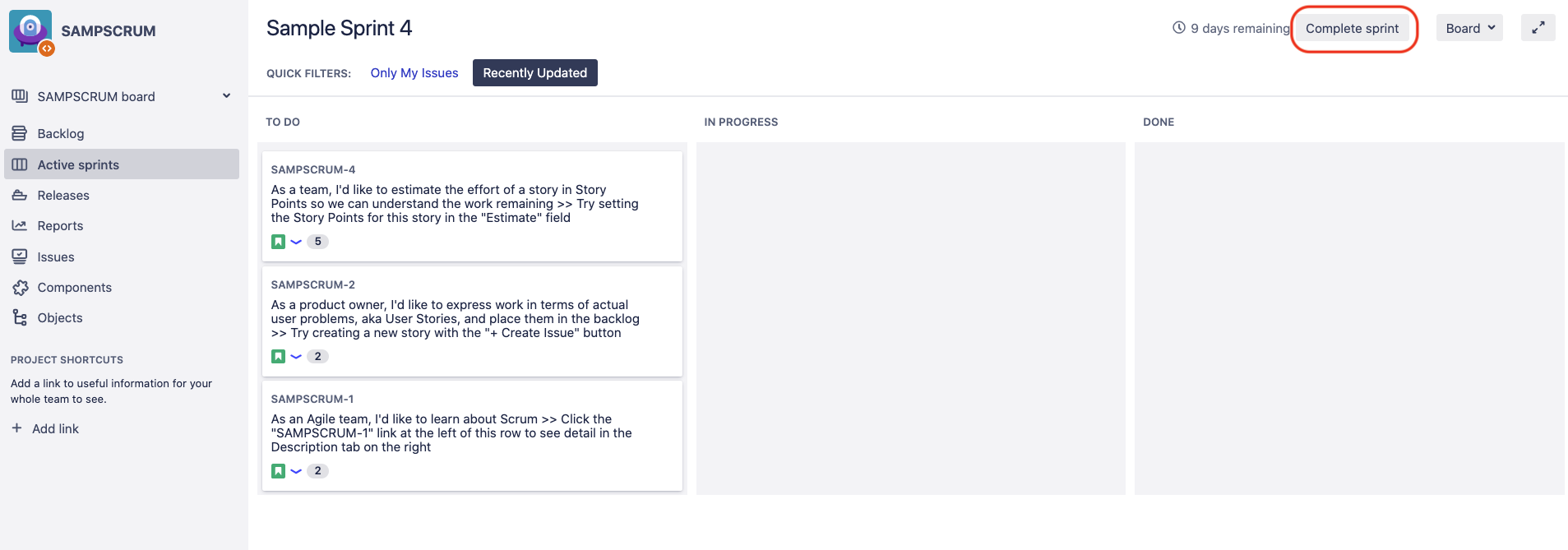

  • Select an active Sprint:
  • After the Sprint is selected, the Complete Sprint button will be displayed in the UI:
