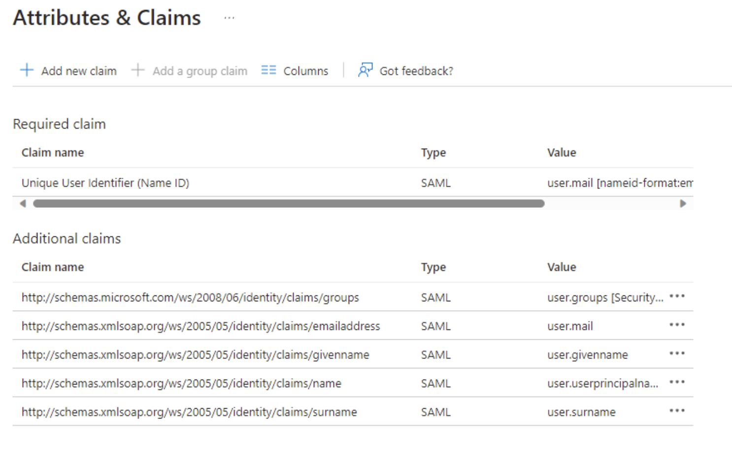

Claims in Azure AD
In Azure AD, we recommend releasing the following claims:
Claim in Azure AD
Common URL
Name ID
http://schemas.microsoft.com/ws/2005/05/identity/claims/name
Given Name
http://schemas.microsoft.com/ws/2005/05/identity/claims/givenname
Surname
http://schemas.microsoft.com/ws/2005/05/identity/claims/surname
Email
http://schemas.microsoft.com/ws/2005/05/identity/claims/email
Groups
http://schemas.microsoft.com/ws/2008/06/identity/claims/groups
ℹ️ In Azure, it generally looks like this:

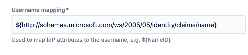

Mapping the Claims in Jira
In Jira, you will navigate to Settings > System > Authentication Methods then select to create a new SAML integration, or edit your existing SAML integration with Azure AD
Then, under the field: Username Mapping, you will want to ensure that it's mapped to Name ID. In most cases, it should look like this:

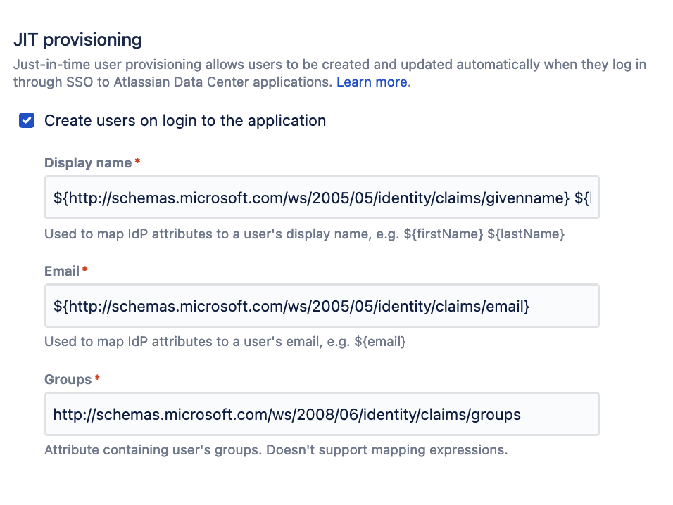

ℹ️ If you plan to enable JIT provisioning, then click on the checkbox "Create users on login to the application" and add the claims above to the rest of the values listed
  • Display name should be a combination of givenname and surname:
    ${http://schemas.microsoft.com/ws/2005/05/identity/claims/givenname} ${http://schemas.microsoft.com/ws/2005/05/identity/claims/surname}
  • Email should be mapped to the email claim:
    ${http://schemas.microsoft.com/ws/2005/05/identity/claims/email}
  • And groups should be mapped to groups, and you should not use the attribute mapping parameters
