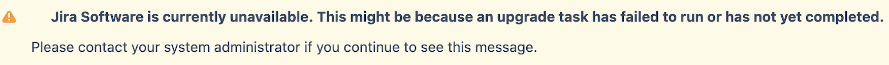

At the top screen on the top you can see the error:
