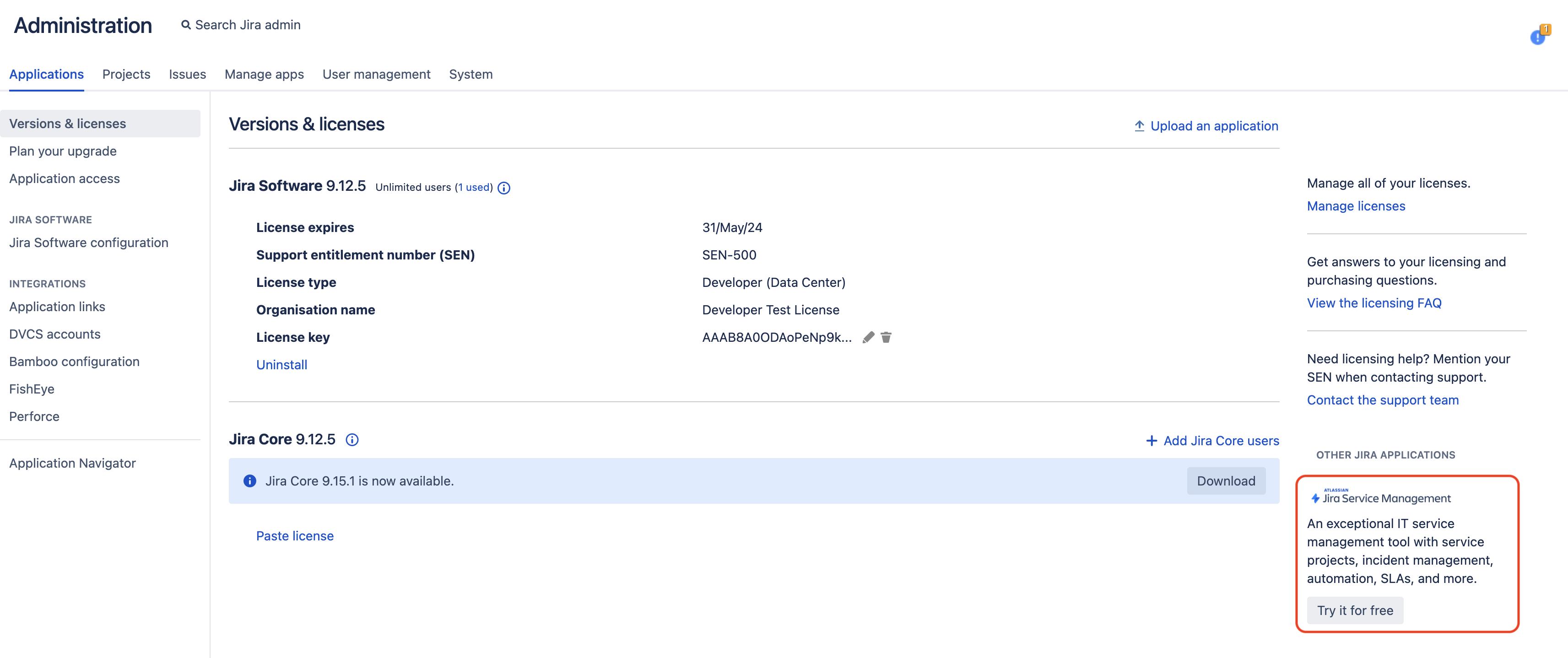

  9. Go to the page Administration > Applications > Versions & license, and install Jira Service Management by clicking on the Install button located under it, as illustrated in the screenshot below:
    1. ℹ️ You might not see the Jira Service Management application listed in this page. It can happen if the JSM application was unlicensed before being un-installed in the 1st Step. In such case, install it using the button Try it for free on the right end side (as shown below), and add a license to it:
