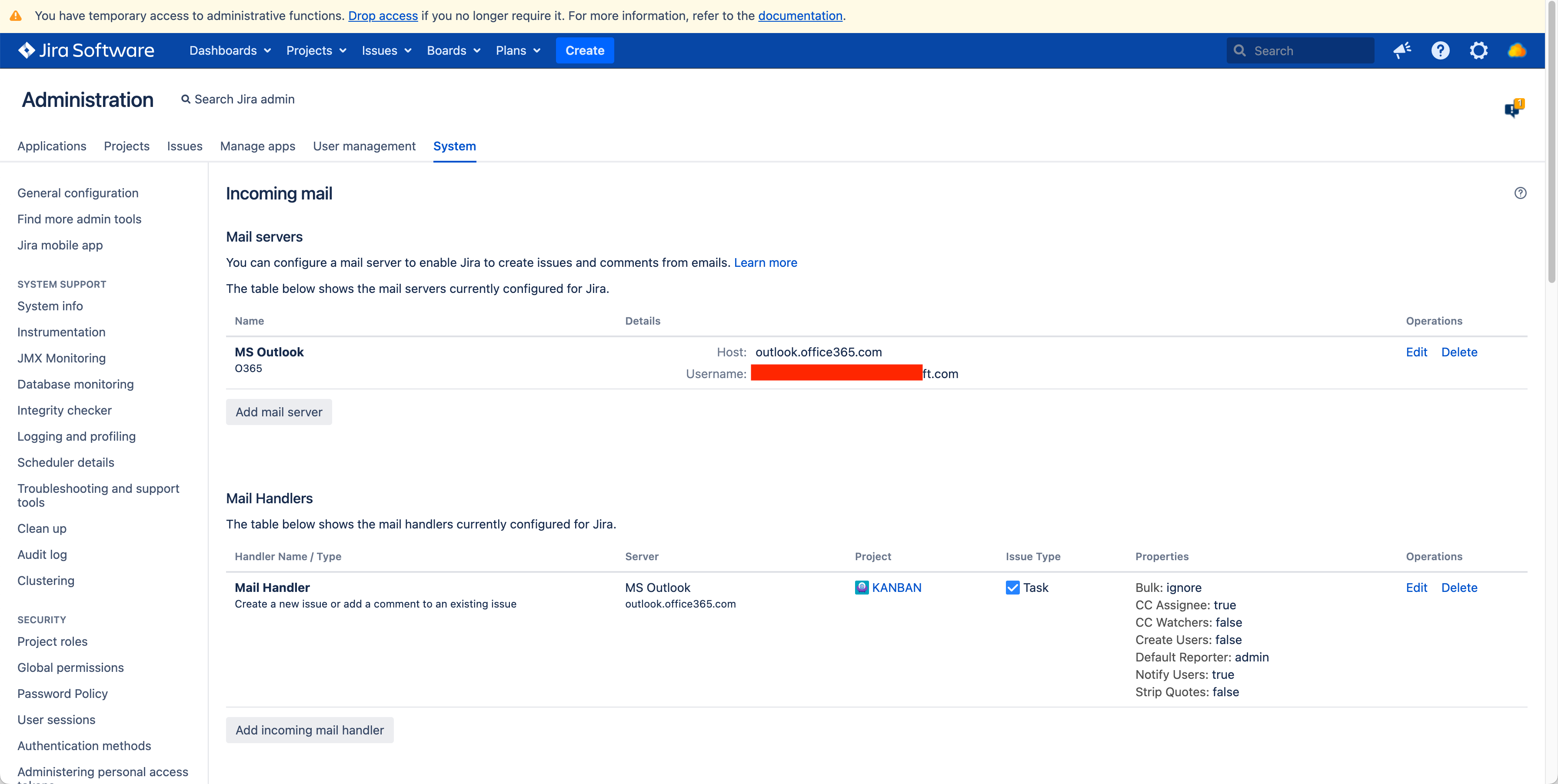

  • Jira application is configured with mail handlers under ⚙ > System>Incoming mail > Mail Handlers

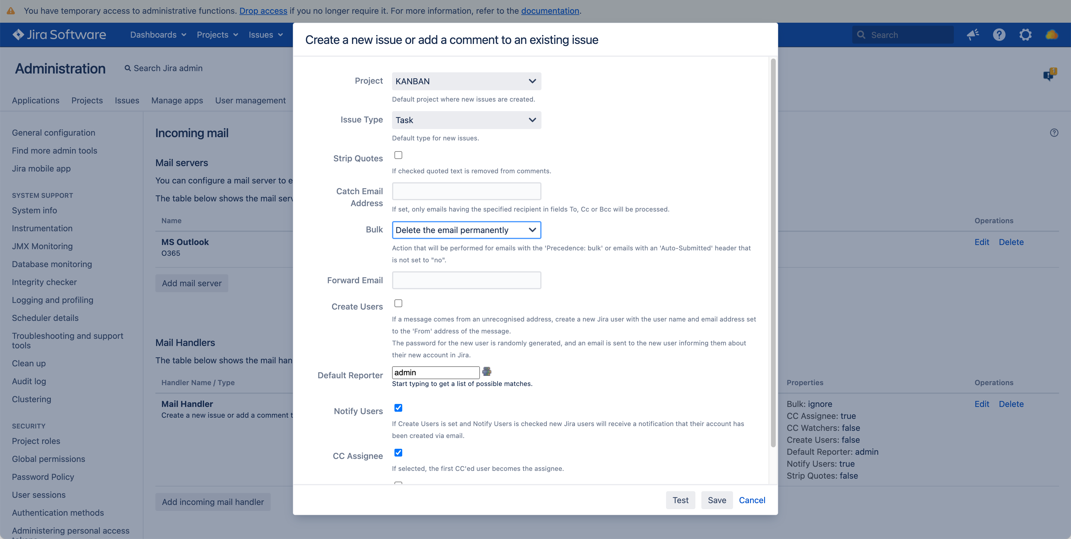

For scenario where the email was rejected due to the bulk detection, the long term solution is to change the mail handler configuration by setting the Bulk field to Delete the email permanently.

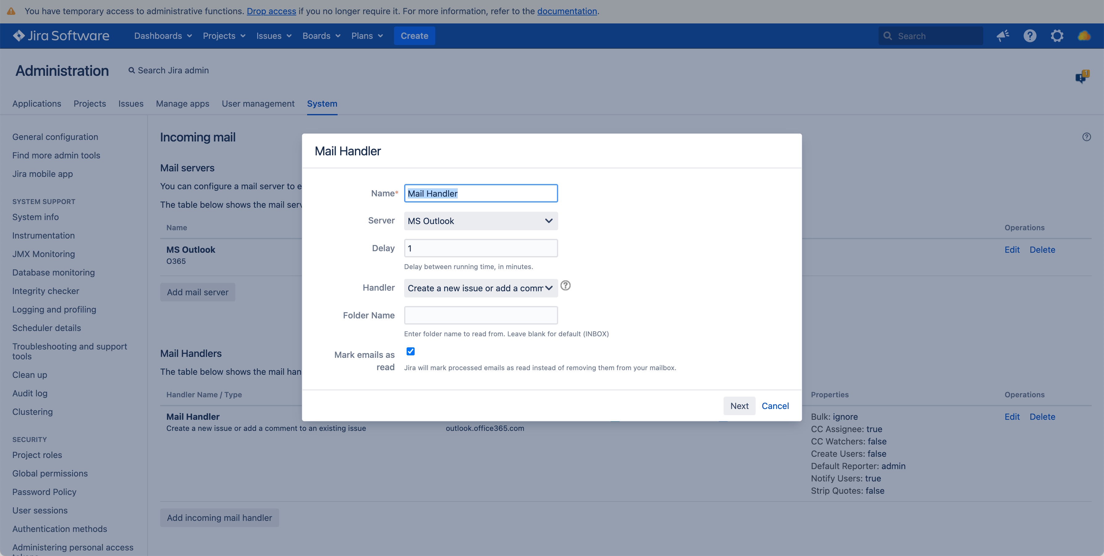

To change the mail handler configuration:
  • Click the Edit button on mail handler configuration in the Incoming Mail configuration page
  • Click Next button on the mail handler configuration
  • Select "Delete the email permanently" in Bulk setting.
