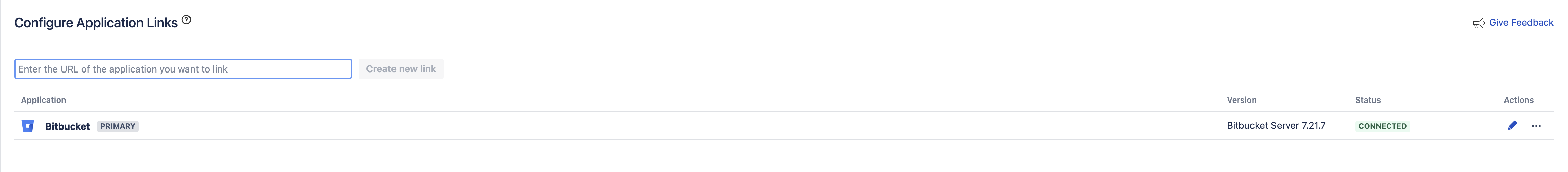

When "local authentication" OAuth is chosen for both Jira and Bitbucket, Bitbucket displays a "Connected" status, but Jira encounters a Network error.
We couldn't connect to Bitbucket at https://xxxxx. This might have been caused by a network error or another configuration error. ''''com.atlassian.cache.CacheException: java.lang.NullPointerException: consumer
This error was discovered in atlassian-jira.log:
2023-08-28 11:56:32,493 https-jsse-nio-8443-exec-8 DEBUG next 716x7152x4 /rest/applinks/3.0/status/cc003b22-06eb-3cfc-8eec-830262bb404c [c.a.a.i.migration.remote.RemoteActionHandler] {"message":"Client must be authenticated to access this resource.","status-code":401} 2023-08-28 11:56:32,494 https-jsse-nio-8443-exec-8 /rest/applinks/3.0/status/cc003b22-06eb-3cfc-8eec-830262bb404c [c.a.a.core.auth.AuthenticatorAccessor] Looking for interface com.atlassian.applinks.api.auth.types.OAuthAuthenticationProvider for application link Bitbucket 2023-08-28 11:56:32,494 /rest/applinks/3.0/status/cc003b22-06eb-3cfc-8eec-830262bb404c [c.a.a.core.property.ApplicationLinkProperties] Getting provider config; key: com.atlassian.applinks.api.auth.types.OAuthAuthenticationProvider 2023-08-28 11:56:32,497 https-jsse-nio-8443-exec-8 WARN /rest/applinks/3.0/status/cc003b22-06eb-3cfc-8eec-830262bb404c [c.a.applinks.core.DefaultApplinkStatusService] Unrecognized error while attempting to retrieve status of Application Link 'cc003b22-06eb-3cfc-8eec-830262bb404c' 2023-08-28 11:56:32,497 https-jsse-nio-8443-exec-8 /rest/applinks/3.0/status/cc003b22-06eb-3cfc-8eec-830262bb404c [c.a.applinks.core.DefaultApplinkStatusService] Unrecognized error trace for 'cc003b22-06eb-3cfc-8eec-830262bb404c'com.atlassian.cache.CacheException: java.lang.NullPointerException: consumer

When OAuth (impersonation) is selected as the "local authentication" method, it functions correctly for both Jira and Bitbucket, displaying a "connected" status.
