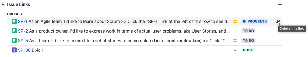

1 - User interface
When the UI is accessible, you can delete the links using the user interface:
