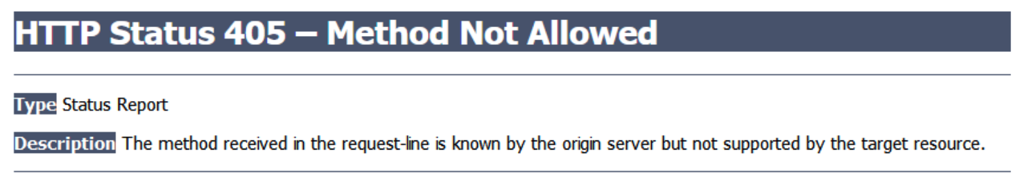

This error can be tricky to navigate, as it indicates that something has gone wrong without telling you why it occurred. This is an HTTP response status indicating that a web browser has requested access to one of your site’s pages.
In this scenario, your Jira has received and recognized the request, but has rejected the specific HTTP method it’s using. In practical terms, this means that the browser can’t access the page it requested. Users will see an error page, rather than the content they were looking for.
However, it has been observed some pattern of this behavior in Jira, where the HTTP Status 405 Method NotAllowed has been known to have related with:

  • When trying to access some pages in Jira, it throws a HTTP Status 405 - Melhod Not Allowed in the page. It could happen when trying to access any Jira pages or any 3rd party plugin console pages:
