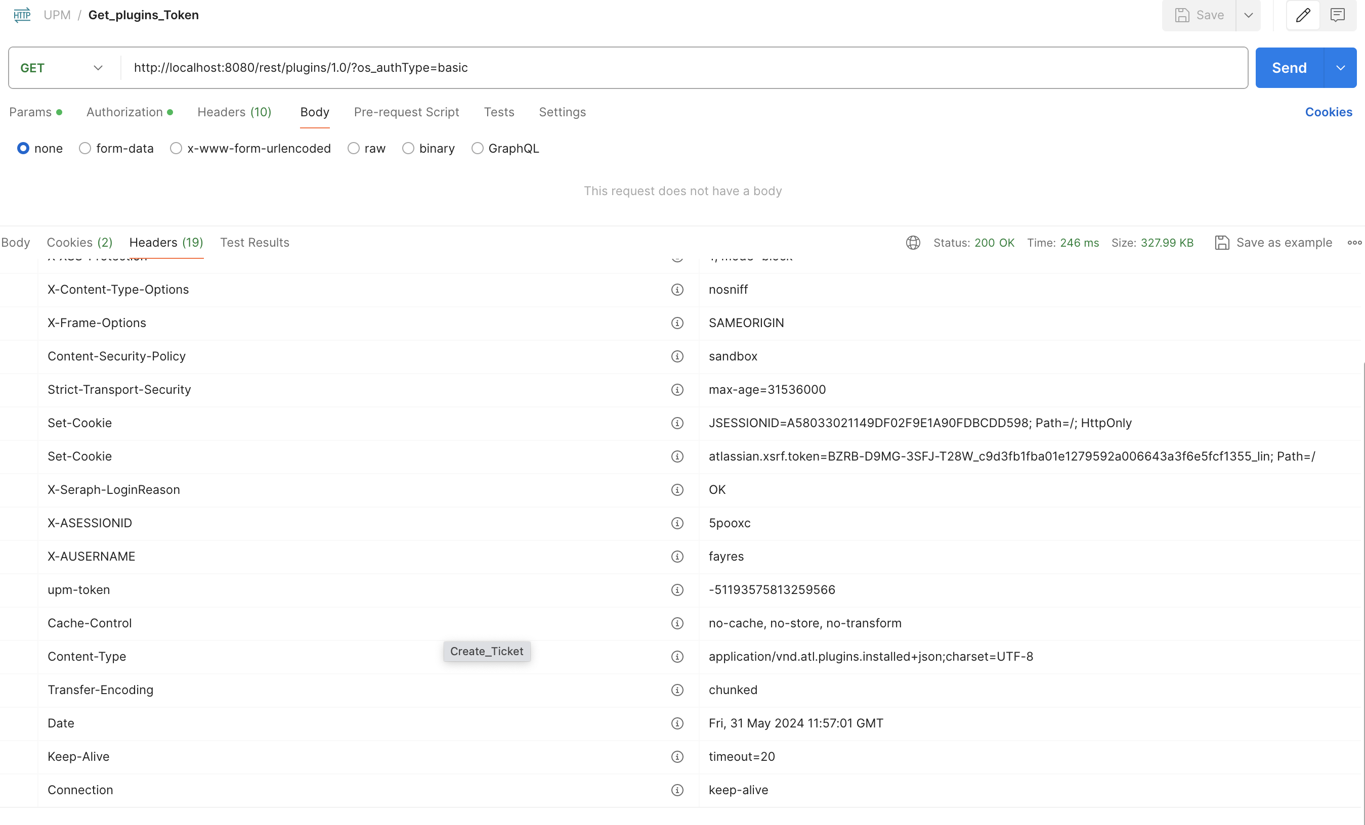

To begin, you must obtain the UPM token. One way to achieve this is by using Postman to send a GET request to the URL endpoint <Jira_base_url>/rest/plugins/1.0/?os_authType=basic.
Make sure to include the following header parameters in the request:
  • X-Atlassian-Token: nocheck
  • Accept: application/vnd.atl.plugins.installed+json
You should employ an authentication method, such as basic authentication.
The 200 OK response will contain in the body a list of Jira plugins.
Within the response header, you will find the parameter upm-token along with a numerical value, potentially paired with a hyphen, for instance, -51193575813259566:
