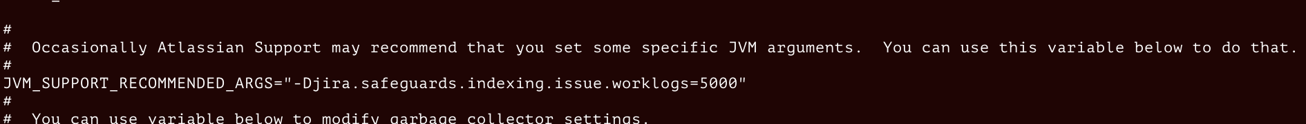

  3. Change JVM_SUPPORT_RECOMMENDED_ARGS="" to JVM_SUPPORT_RECOMMENDED_ARGS="-Djira.safeguards.indexing.issue.worklogs=5000" , for example, reference the screenshot below. Please note that the 5000 is an example value.
