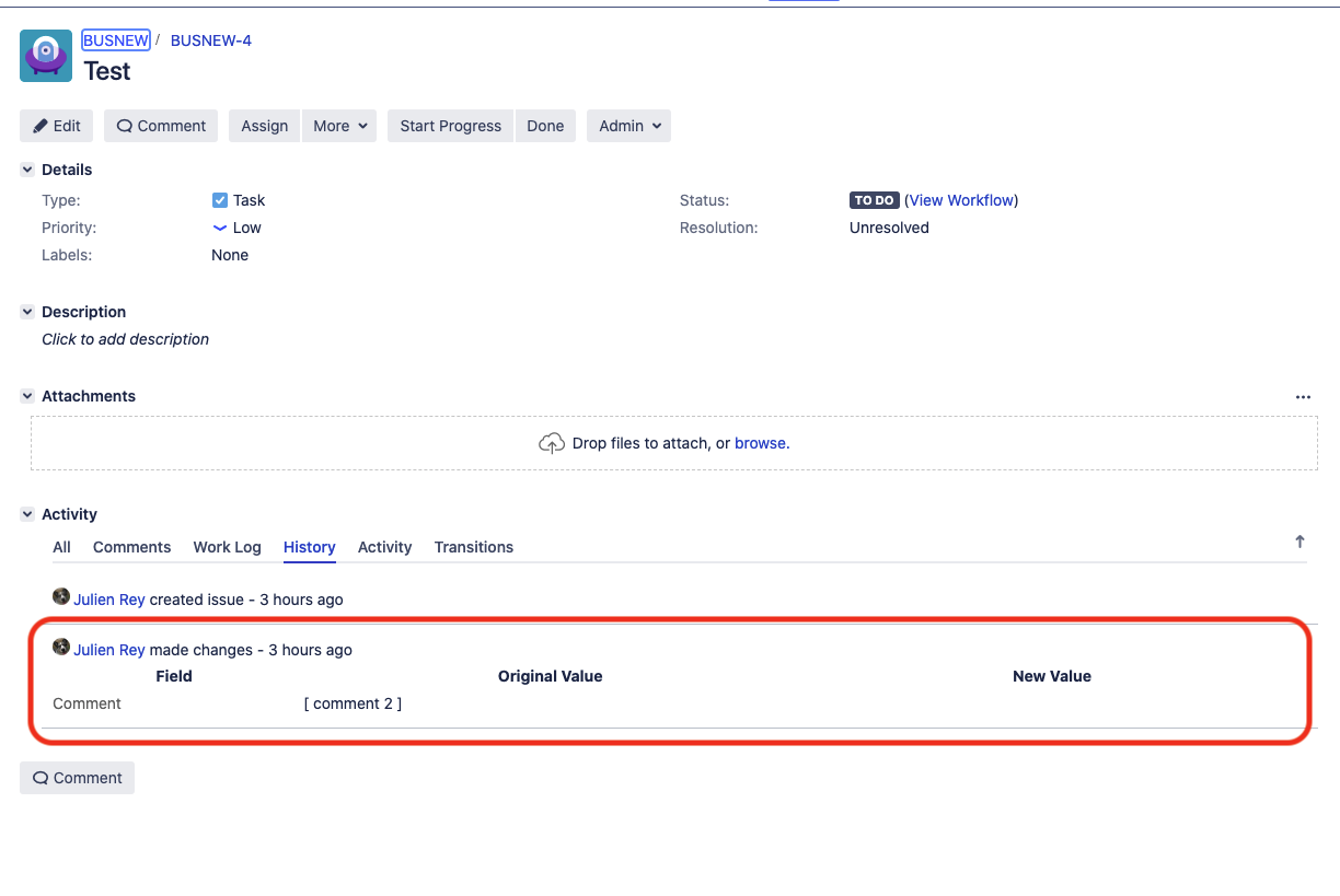

Solution 1 (from the UI)
The easiest way to check who deleted a comment from an issue is to open the issue in the Jira UI, and then click on the History tab at the bottom of the issue.
From the history tab, you'll be able to see who deleted a comment in the ticket, as shown in the example below. If you see a comment on the left side and nothing on the right side, then it means that the comment was deleted:
